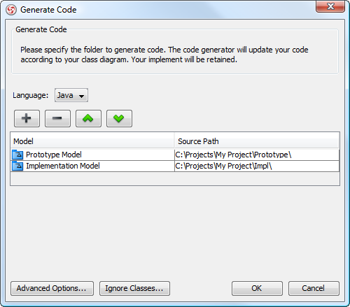

  1. Select Tools > Code Engineering > Java Round-trip > Generate Code... from the main menu.
  2. In the Generate Code dialog box, specify the mapping between model and source path. Model is a UML element that acts as a container of other elements. Classes and packages under a model will be generated to the mapped source path. You can add multiple model-to-source-path mapping by pressing the + button. If you are not using model to structure your project, or if you want to generate all classes in project to the same folder, regardless of their parent model, keep model to be <root>.

  1. Right click on the class diagram background and select Utilities > Java Round-trip > Generate Code from the popup menu.
  2. In the Generate Code dialog box, specify the source path where you want the code to be generated. Model is a UML element that acts as a container of other elements. Notice that source path is set for model, not for diagram. Classes and packages under a model will be generated to the mapped source path. You can add multiple model-to-source-path mapping by pressing the + button. If you are not using model to structure your project, or if you want to generate all classes in project to the same folder, regardless of their parent model, keep model to be <root>.

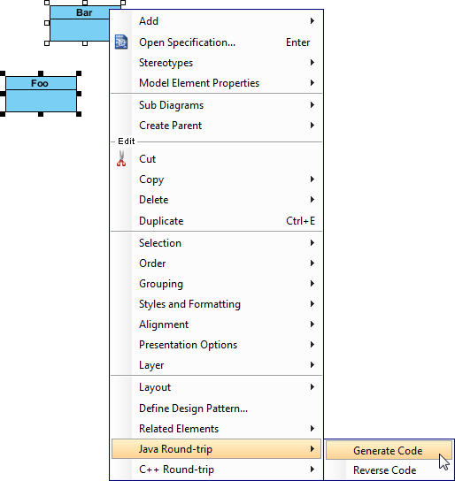

Generating/Updating code from chosen classes
You can generate Java code from specific class or classes. To generate code from class/classes:
  1. Select the class(es) and right click on them, then select Java Round-trip > Generate Code from the popup menu.
    To generate code for classes
    The mappings between models and source paths are defined
    NOTE: If you have generated code for once, the Generate Code dialog box will not appear next time you generate/update code for any class selection. If you want to configure the model-to-source-path mapping or to configure options, you can run a code generation for project (refer to the previous section for detail).
  3. Optionally configure the advanced code generation options by clicking Advanced Options.... Read the section Advanced Options in this chapter for details about the options.
  4. Click OK to proceed with generation.
NOTE: Documentation in model elements is generated as comment in code.

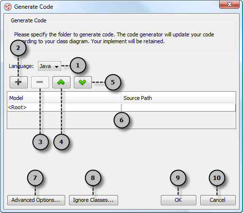

An overview of Generate Code dialog box
No. NameDescription
1 Language The programming language of the source code to generate.
2 Add model-to-source-path mapping Click to add a new mapping between UML model and the source path where code will be generated to.
3 Remove model-to-source-path mapping Click to remove chosen model-to-source-path mapping.
4 Move model-to-source-path mapping up
Click to move chosen model-to-source-path mapping one item upward.
5 Move model-to-source-path mapping down
Click to move chosen model-to-source-path mapping one item downward.
6 Model-to-source-path mapping A list of mapping between UML model and source path.
7 Advanced options Click to configure advanced code generation options. For details, read the section Advanced Options in this chapter.
8 Ignore classes Click to organize the ignore list of classes to ignore in code generation. For details, read the section To ignore classes in generation in this chapter.
9 OK Click to start generation.
10 Cancel Click to close the Generate Code dialog without generating code.
A description of Generate Code dialog box

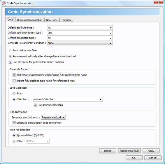

You can configure the advanced options for more control of the code by clicking the Advanced Options... button in Generate Code dialog box. In the Code Synchronization dialog box popped up, there are four categories (tabs) of settings you can configure. Below is a description.
Code
Code configuration
Code configuration
OptionDescription
Default attribute type (default int) Type that will be assigned to Attribute upon code generation when type is unspecified
Default operation return type (default void) Return Type that will be assigned to operation upon code generation when return type is unspecified
Default parameter type (default int) Type that will be assigned to Parameter upon code generation when type is unspecified
Auto realize interface (default false) Generate operations defined in interface in sub-classes
Remove method body after changed to abstract method (default true) When an operation is set from non-abstract to abstract, updating code will remove the related method's body
Use "is" prefix for getters that return boolean (default true) Generate getter's name as isXXXX() for getters that return a boolean value
Add import statement instead of using fully qualified type name (default true) Add import statement for referencing classes in another package/namespace instead of using fully qualified name inline
Import fully qualified type name for referenced type (default false) Use fully qualified type name in import statements instead of using wildcard character * to represent importing all classes in package
Java Collection
  • Array - Generate one-to-many relationship as array
  • Collection - (default) Generate one-to-many relationship as collection
Use generic collections (default true) Allow to use generic collection
Generate annotation on
  • Property method - Generate annotation on property method
  • Field - Generate annotation on field
Generate annotation in code convention (default true) Generate annotation in code convention
Text File Encoding
  • System default - (default) The default system encoding will be selected as encoding for source files
  • Other -Specify an encoding for source files
A description of code configuration

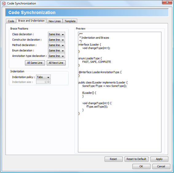

Brace and Indentation
Brace and indentation configuration
Option
Description
Class declaration
  • Same line - (default) Brace for class declaration appear at the same line as the declaration
  • Next line - Brace for class declaration appear at the line after the declaration
Constructor declaration
  • Same line - (default) Brace for constructor appear at the same line as the declaration
  • Next line - Brace for constructor appear at the line after the declaration
Method declaration
  • Same line - (default) Brace for method appear at the same line as the declaration
  • Next line - Brace for method appear at the line after the declaration
Enum declaration
  • Same line - (default) Brace for enumeration appear at the same line as the declaration
  • Next line - Brace for enumeration tor appear at the line after the declaration
Annotation type declaration
  • Same line - (default) Brace for annotation type appear at the same line as the declaration
  • Next line - Brace for annotation type appear at the line after the declaration
Indentation policy
  • Tabs - (default) Use a tab of space as indentation
  • Spaces - Use spaces as indentation. The number of spaces can be defined below
Indentation size The number of spaces to indent
A description of brace and indentation configuration

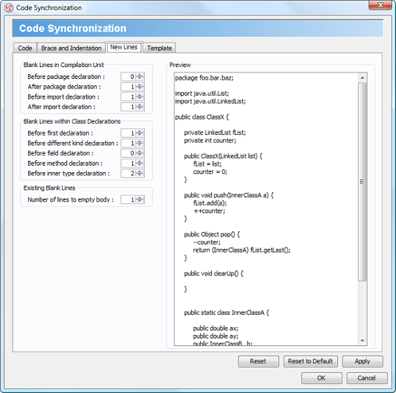

New Lines
New lines configuration
Option
Description
Before package declaration Number of blank lines to appear before Package declaration
After package declaration Number of blank lines to appear after Package declaration
Before import declaration Number of blank lines to appear before import statements
After import declaration Number of blank lines to appear after import statements
Before first declaration Number of blank lines to appear before the first declaration within Class declarations
Before different kind declaration Number of blank lines to appear before a different kind of declaration
Before field declaration Number of blank lines to appear before field declaration
Before method declaration Number of blank lines to appear before method declaration
Before inner type declaration Number of blank lines to appear before inner type declaration
Number of lines to empty body Number of blank lines to appear in empty method body
A description of new lines configuration

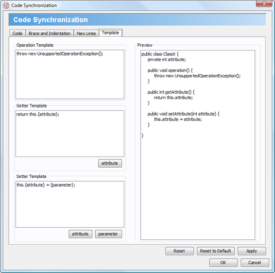

Template
Template configuration
Option Description
Operation Template Defines a template of method body that will be applied when generating operations.
Getter Template Defines a template of getter that will be applied when generating getter methods. Getter will be generated to attribute stereotyped as Property, or with property getter selected.
Setter Template Defines a template of setter that will be applied when generating setter methods. Setter will be generated to attribute stereotyped as Property, or with property setter selected.
A description of template configuration
