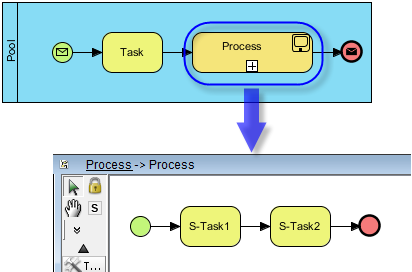

In BPMN, there are two kinds of activity - task and sub-process. To represent either an empty BPEL activity or an invoke of BPEL activity, you use a task with proper type set. Sub-process, on the other hand acts as a placeholder of a set of tasks. You can draw a sub-process, expand it and draw the tasks in the sub-process diagram. Note that only sub-process with type Embedded is considered in BPEL generation. The other types will be ignored.
A sub-process and its sub-process diagram
When you generate BPEL, the flow modeled in sub-process diagram will be merged to the ordinary flow. The following code fragment shows a BPEL file generated from the above BPDs. The empty activities STask1 and STask2 were modeled in the sub-process diagram, and they follow the empty activty Task in the main flow.
