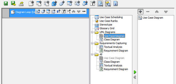

To loop specific type(s) of diagrams in project, create diagram loop at template root. To create diagram loop at template root:
  1. In the template editor, click on the  on toolbar.
  2. On the right hand side of the template editor, select the type of diagram(s) to loop and click  to confirm the selection.
    Select to loop use case diagram

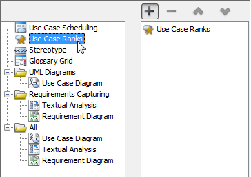

Including use case scheduling,ranks, stereotypes and various grid in report
Use case scheduling, use case ranks, stereotypes and various grid fall into the category of diagram. If you want to print them to report, follow the steps as described in the previous section, and to select the appropriate content to include at the final step.
Choosing to include information of use case ranks in template
