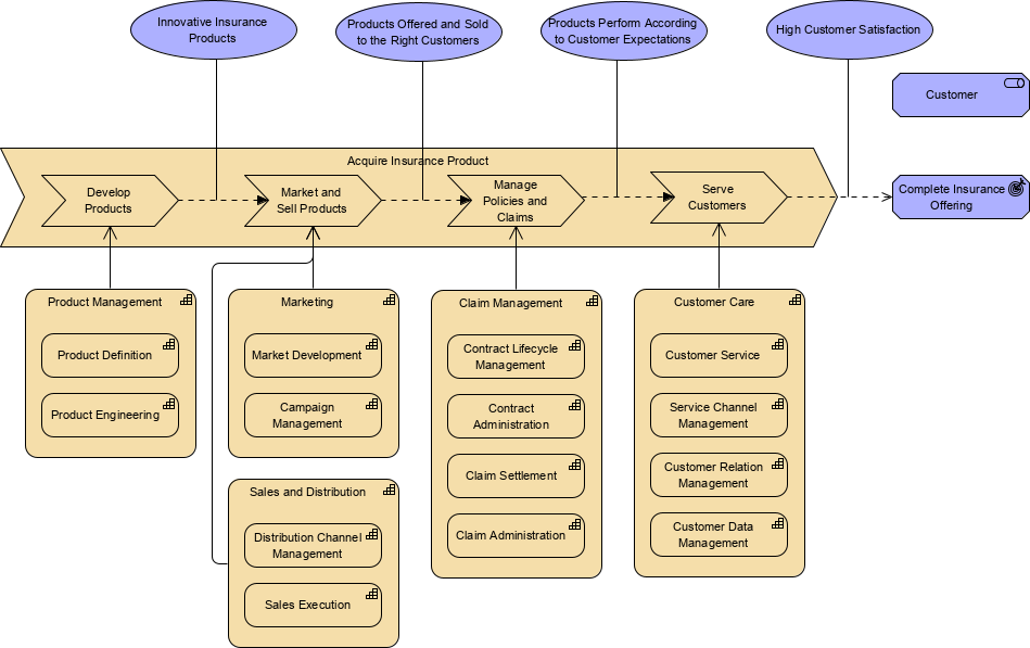

The example below shows a model of a high-level value stream for an insurance company, where each stage in the value stream is served by a number of capabilities. Between these stages, we see the value flows with associated value items, and at the end the business outcome that this value stream realizes for a particular stakeholder.
Between the stages of the value stream, we see the value flows with associated value added by each stage, and at the end the business outcome of ‘well-founded decision-making’ that this value stream realizes for a particular stakeholder. Each stage in the value stream requires a number of capabilities, shown below the stages and also exhibiting how you can use the improved grouping concept to model this cross-mapping efficiently.
Resources can be assigned to value streams and capabilities can serve (i.e., enable) a value stream. This supports the common technique of capability–value stream cross-mapping, where you identify which capabilities the enterprise needs or uses to support the stages in a value stream.

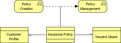

The Example below illustrates two directed association relationships between a contract and two business objects to which this contract refers. It also shows an association between a flow relationship and this contract, to indicate the kind of information that is communicated between the two functions.

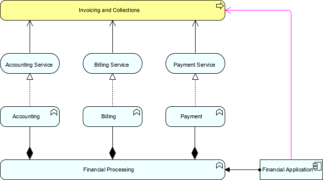

In Example below, assume that the goal is to abstract from the application functions, sub-functions, and services in the model. In this case, an indirect serving relationship (thick red arrow on the right) can be derived from “Financial Application” to the “Invoicing and Collections” business process (from the chain assignment – composition – realization – serving).
