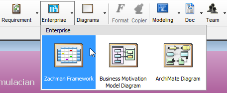

  3. Let's create a Zachman Framework. Click on Enterprise in toolbar. Select Zachman Framework from the popup menu.
    create zachman framework

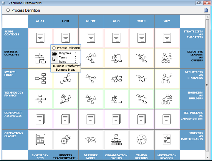

  4. There are 36 cells in Zachman Framework. Select the one that intersect How (column) and Business Concepts (row).
    cell selected

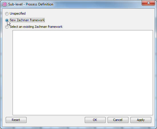

  6. In the Sub-Level window, select New Zachman Framework. Click OK.
    sub level

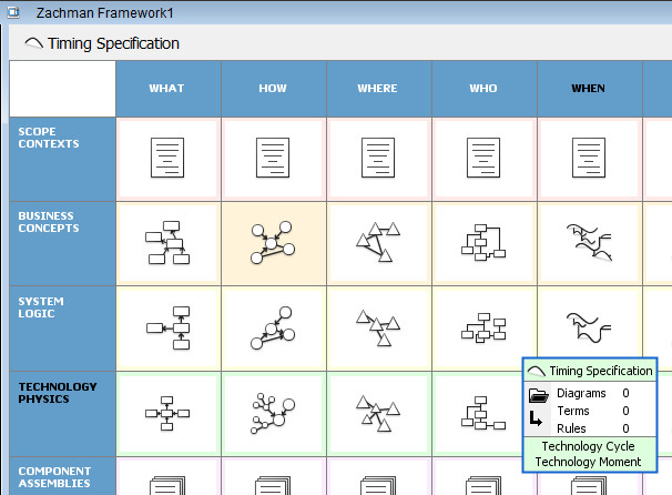

  7. Check the caption of Zachman Framework. You are now opening the sub-level of Zachman Framework1.
    sub level created

  9. Select any other cell in Zachman Framework. You can see that the cell with sub-level is filled.
    cell filled

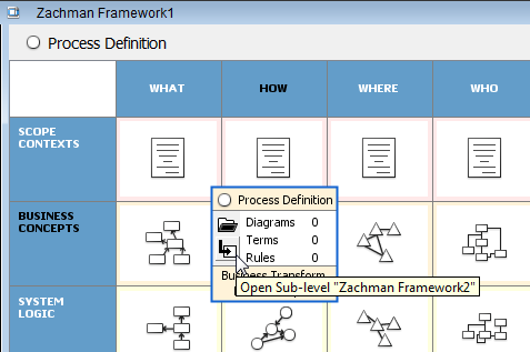

  10. Select the edited cell again. Now, you can open the sub-level by clicking on the arrow button.
    open sub
