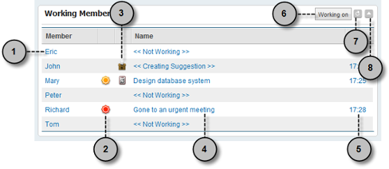

The Working Member widget
Region Description
1 Name of team member.
2 Symbol that indicates the priority of Resource. From most to least urgent: Red, orange, yellow, green, blue.
3 Symbol that indicates type of Resource a member is working on.
4 What a member is working on. It can be the name of a Resource or a text description the member entered manually.
5 The time that a member has started working on the task he reported.
6 Click this button to report what you are working on.
7 Click to refresh the content of widget.
8 Click to collapse or expand the widget.
