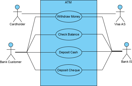

Use Case Example – ATM
In the example below, the Visa Card Holder and Bank Customer are Primary Actors, while the Visa AS and Bank IS are secondary actors.
Use Case Diagram ATM example

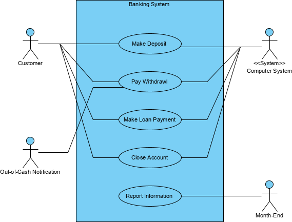

Use Case Diagram Example – Banking System
A bank provides common banking services to retail customers which include: Deposit, Withdraw, Loan or Mortgage payment and other account management services:
Use Case Diagram banking system example
