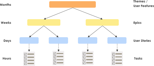

  • At the top of this Figure above is the orange, largest bricks. They represent the business goals to be achieved by the system, namely use cases or user features.
  • At the next level down are PBIs that are bigger than a single sprint but smaller than a release. Let’s call the PBI at this level epics.
  • At the third level, we find PBIs that are sized appropriately for a sprint—they can be completed in days rather than weeks. These items meet the team’s Definition of Ready and can be represented as user stories.
  • At the lowest level, these PBIs can optionally to be broken down into tasks from user stories and delivered by the end of a single iteration.

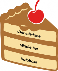

It’s recommended from an agile perspective that teams work on stories that consist of vertical pieces of the cake; in other words, slices. People don’t eat layers of a cake. We don’t eat all the top layer before we start eating the second layer – we cut the cake into slices (thin or thick, depending on your preference and diet) and then eat those. Again, looking at the cake as the whole product,
Let’s consider the “cake” analogy in an agile perspective, the idea is that a working demonstrable feature (software) is a multilayered cake. The cake would constitute all of the work and each layer would represent all of the work for that part of the product. A vertical slice of cake means a user story should contain work for as many of the different layers as possible.
Vertical Slice vs Horizontal Slice
A user story is broken down vertically, they are broken down in such a way that smaller items still result in working, demonstrable, software, or a specific working feature useful for the user. In other words, a vertical slice means a bit of every layer. Again as an example, a new feature request like “showing x information on the main screen” would contain these work bits:
  • Work in the UX/UI that will display the information
  • Work in the service layer to transform the information
  • Work in the database layer to store/fetch the information.

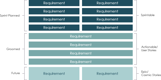

In the product backlog above, product backlog items (PBIs) are classified as three different categories readily for sprint planning:
  • Sprinted Planned: Sprintable
  • Groomed: Actionable / user stories
  • Future: Epic / Cosmic Stories
By maintaining a well-categorized product backlog like the structure above, your team should be more ready to proceed to the sprint planning process.
