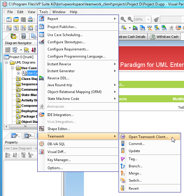

  1. Open the Teamwork Client by selecting Tools > Teamwork > Open Teamwork Client from the main menu.

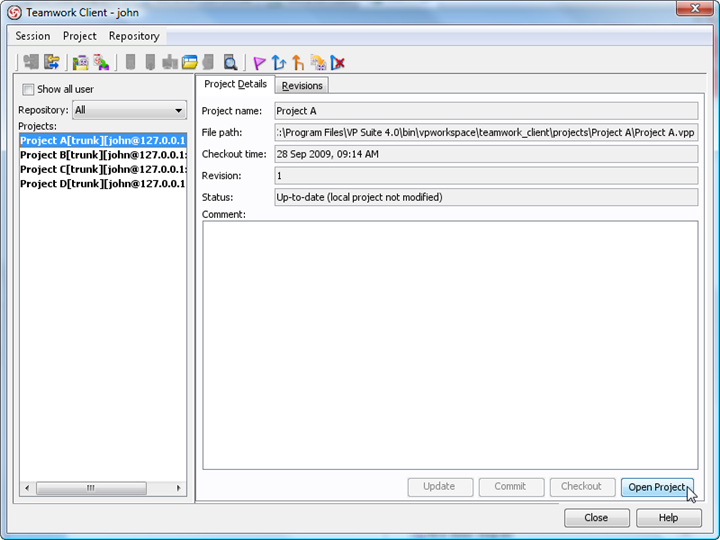

  2. The projects that you are managing are listed at the left hand side of the Teamwork Client dialog box. What you need is to commit all modifications made on the projects checked out. Select the first one. Click Open Project at the bottom right of the dialog box.

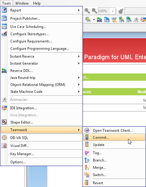

  3. Select Tools > Teamwork > Commit in the main menu to commit changes.

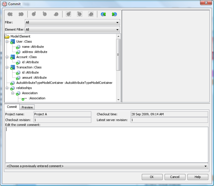

  4. If the Commit Project dialog box appear, this indicates that there are uncommitted changes. Click OK to proceed with committing. (You may leave a comment if necessary)

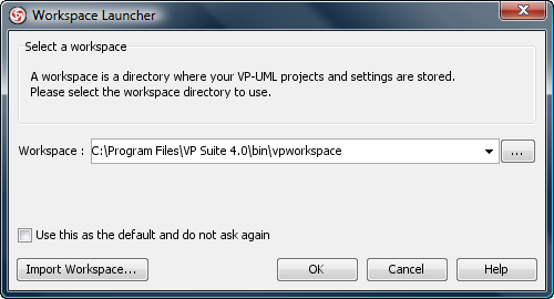

  1. If you don't know where the workspace is, select File > Switch Workspace... from the main menu. The path that appear in the Workspace field is the workspace folder.

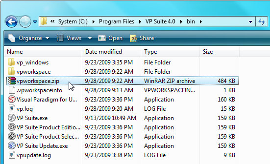

  3. Zip the whole workspace folder.
    workspace zipped
