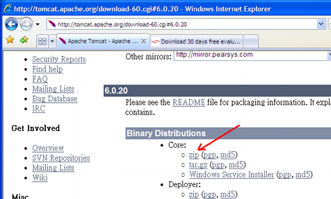

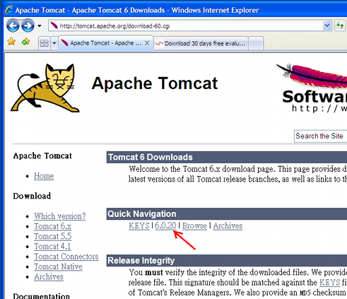

  1. Visit Tomcat download page at http://tomcat.apache.org/download-60.cgi.
    Select tomcat version
  2. Click 6.0.20 to download.
  3. Download the Binary Distributiions by clicking the zip.
    Download tomcat

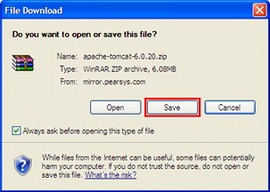

  4. Save the file in local machine.
    Save as

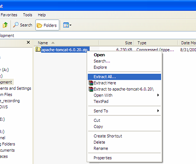

  5. After finished the download, open the folder where the file was saved to.
  6. Right-click on the downloaded file and select Extract All....

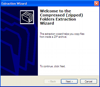

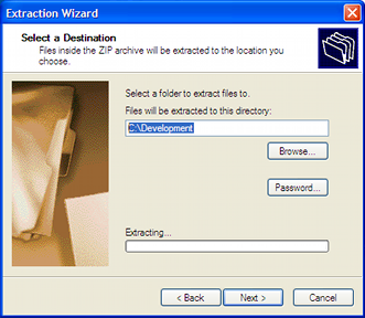

  7. Follow the wizard to extract the file.
    Extract wizard

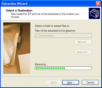

  8. Specify the folder for extraction, e.g. C:\Development.
    Extract wizard - select path
  9. It will extract a folder apache-tomcat-6.0.20 in C:\Development.
    Extract wizard - extracting

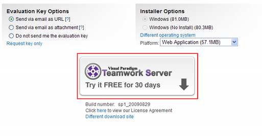

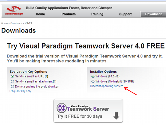

  10. Download Visual Paradigm Teamwork Server from http://www.visual-paradigm.com/download/vpts.jsp.
  11. After login, click Different operating system.
    Download TS - select operating system

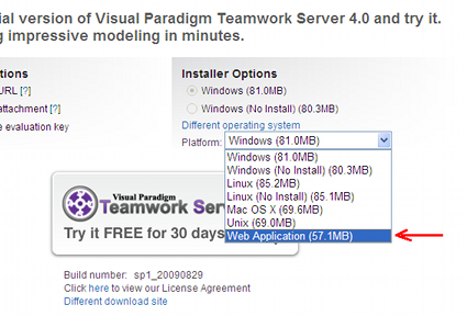

  12. Select Web Application in the Platform combo box.
    Download TS - web application
  13. Then click the image of Teamwork Server in the center to download.
    Download TS

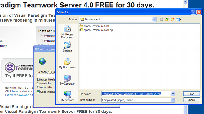

  14. Also save to C:\Development.
    Save as

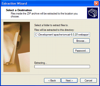

  17. Due to the downloaded Visual Paradigm Teamwork Server is a web application of Tomcat, so let's specify the folder in the Tomcat for extraction, e.g. C:\Development\apache-tomcat-6.0.20\webapps.
    Extract TS

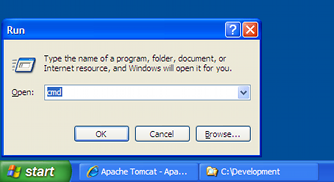

  18. After extracted the files, open the command prompt by running cmd.
    Open command prompt

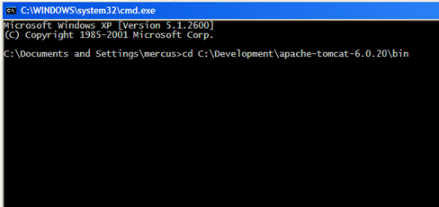

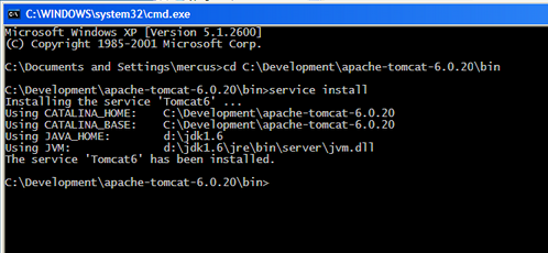

  19. Change the current directory to the bin folder of the Tomcat, e.g. "C:\Development\apache-tomcat-6.0.20\bin" by:
    cd C:\Development\apache-tomcat-6.0.20\bin.
    Tomcat bin folder

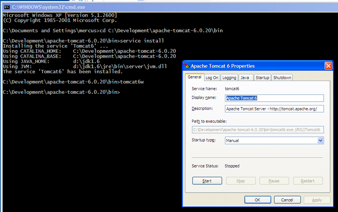

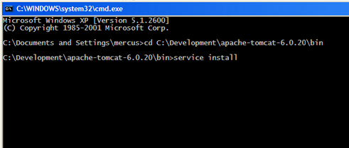

  20. After changed the current directory, you can install Tomcat as a service by:
    service install
    Install service
  21. Tomcat service is installed.
    Install service result

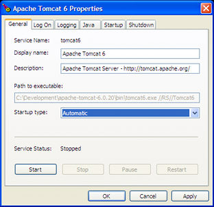

  22. Change Tomcat service properties by open its properties dialog with:
    tomcat6w
    Tomcat service
  23. In the dialog, change the Startup type: to Automatic.
    Tomcat service - automatic

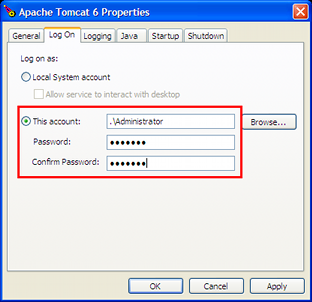

  24. Then click the Log on tab, specify the account for running this service.
    Tomcat service - user
  25. Click OK button to apply the change.

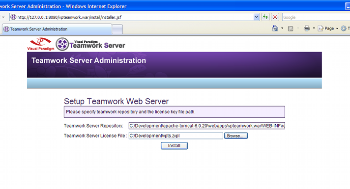

  27. After rebooted, the Teamwork Web Server is available by visiting http://127.0.0.1:8080/vpteamwork.war/
  28. For the first time to run Teamwork Web Server, it will show the installation page. Specify the license file and then click Install.
    Setup TS

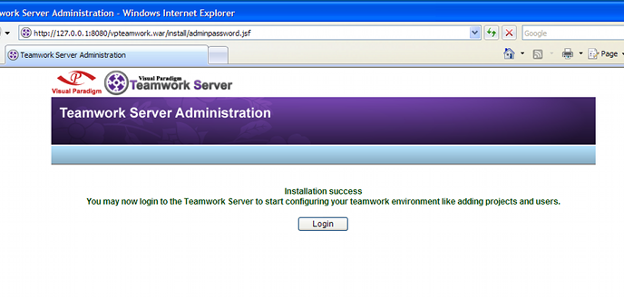

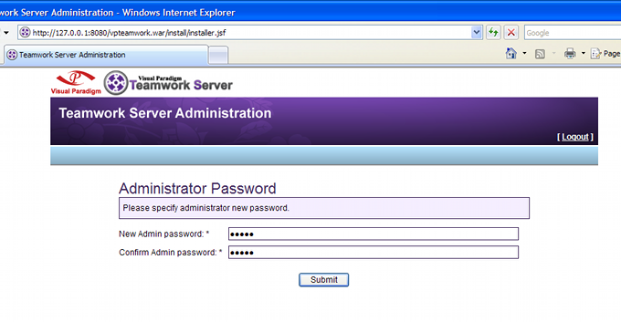

  29. After installed, you can specify the password of administrator of the Teamwork Web Server.
    Setup TS - administrator password
  30. After specified the password, the installation will be done.
    Setup TS - done
  31. You can login as administrator to set up the teamwork environment.
