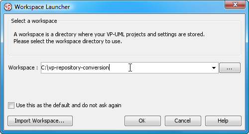

  1. Install VP Suite with VP-UML selected.
  2. Start VP-UML. The workspace is a folder where the projects will be checked out to.
    select workspace

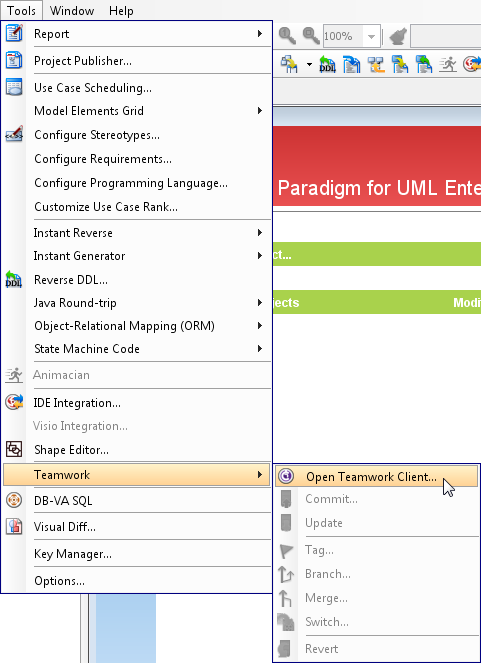

  3. Select Tools > Teamwork > Open Teamwork Client... from the main menu to start Teamwork Server.
    open teamwork client

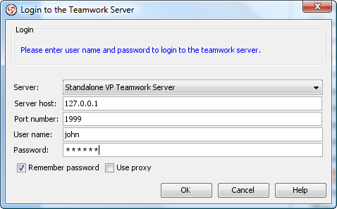

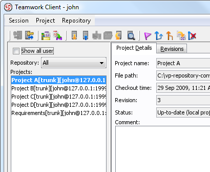

  4. Login to the server with a user that has right to checkout all projects in the server.
    login

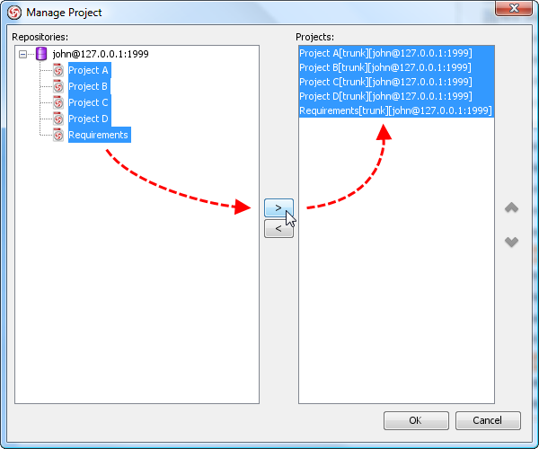

  5. In the Manage Project dialog box, select all projects, and click > to select them. Click OK to proceed.
    manage projects

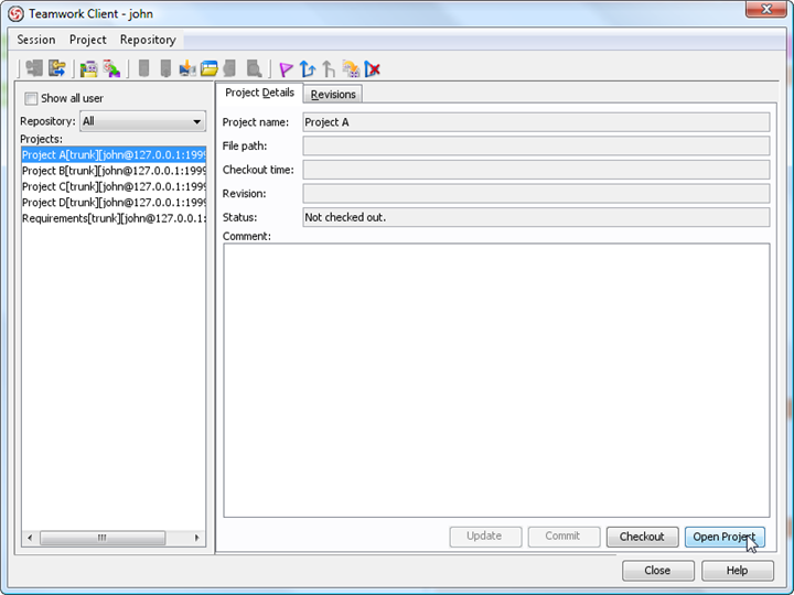

  6. Click Open Project at the bottom right of the Teamwork Client dialog box.
    open prj

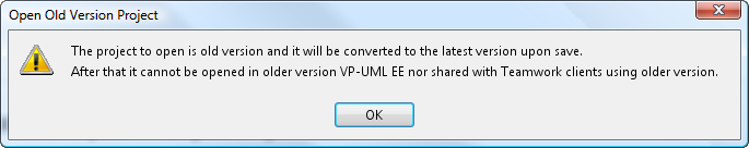

    You should see the message below, meaning that the project is yet to be upgraded. Click OK to proceed.
    open old version prj

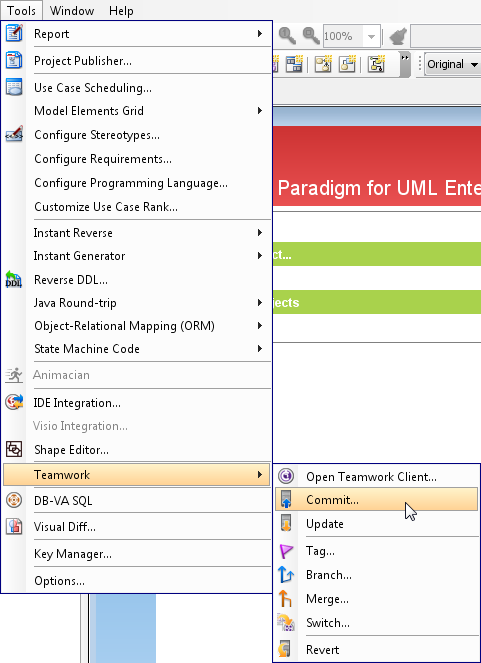

  7. Perform little change on the project(e.g. move shapes a little bit) so that Teamwork Server will be able to detect changes, and commit the latest project to server.
    move shapes

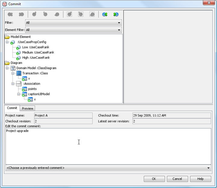

  8. Commit the project immediately back to the server by selecting Tools > Teamwork > Commit... from the main menu.
    commit project
  9. Enter Project upgrade in the Commit dialog box and click OK to proceed with committing.
    commit project2
