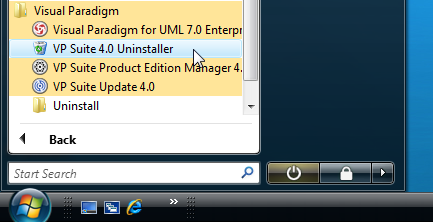

  1. Execute the uninstaller of VP Suite from the Start menu.

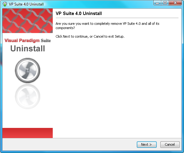

  2. Follow the on-screen instructions to finish the un-installation.

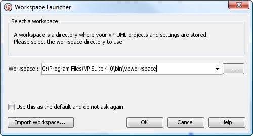

  1. Start the client with existing workspace.

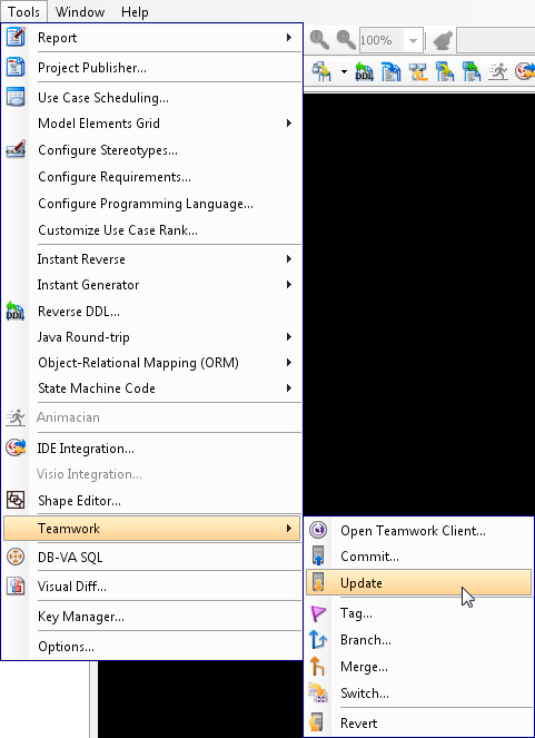

  2. Select Tools > Teamwork > Update.
