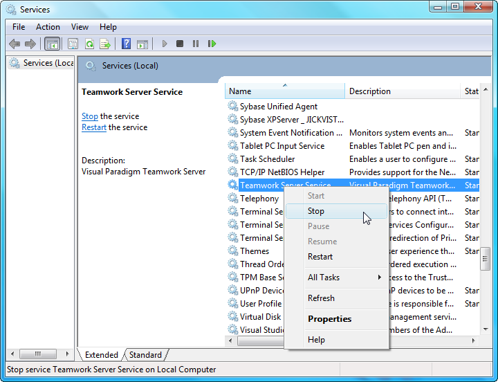

For users who had install Teamwork Server as a window service, you need to the service before proceeding. To stop:
  1. Start the Windows Control Panel.

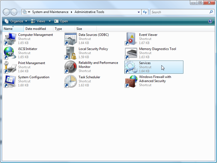

  2. Access the installed services by selecting Services at System and Maintenance\Administrative Tools.
    execute service
  3. Stop the service Teamwork Server Service.
    stop service

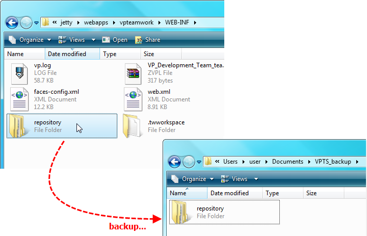

  1. Open the %teamworkserver_installation_directory%\jetty\webapps\vpteamwork\WEB-INF folder.
  2. The folder repository conains the revisions of projects and configuration. Copy the repository folder to elsewhere for backup.
    backup repo

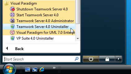

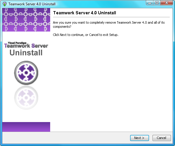

  1. Run Teamwork Server Uninstaller from the Start Menu.
    uninstall vpts
  2. Finish the uninstallation.

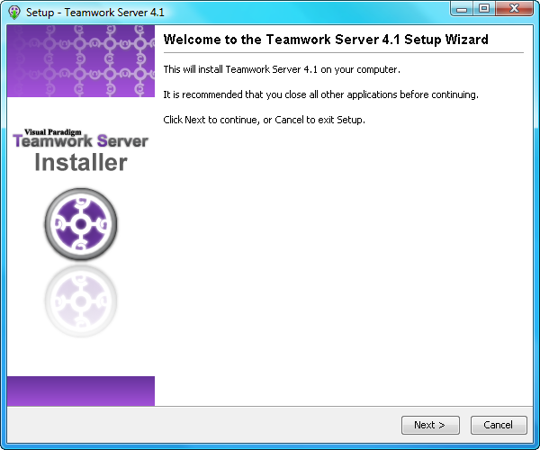

  1. Execute the installer of the new version. Following the on-screen instruction to proceed until the Server Configuration page.
    welcome

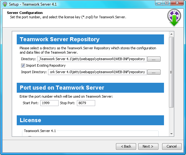

  2. In the Server Configuration page, check Import Existing Repository, and specify the path of the old version repository. Click Next.
    import repo

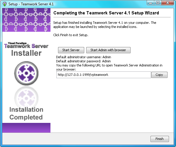

  3. Complete the installation until the Installation Completed screen appear.
    completed installation
Server Completeness Check
  1. In the Installation Completed page (see the final step of the previous section), click Start Server, then click Start Admin with Browser.
    Note: This can be done in another machine simply by visiting http://%IP_ADDRESS%:1999/vpteamwork where %IP_ADDRESS% is the Teamwork Server IP address. Also make sure that the firewall of the server is configured appropriately.

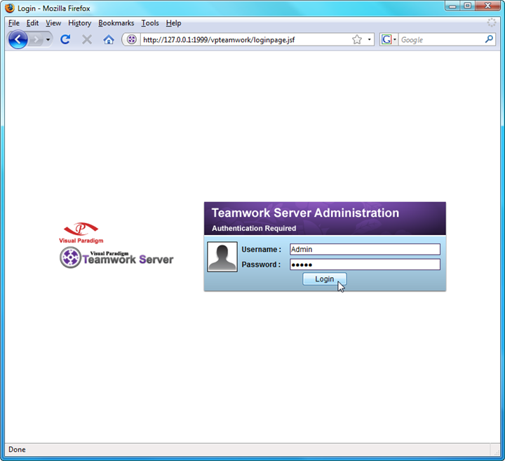

  2. Login the Teamwork Server as administrator.

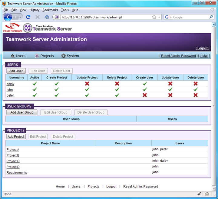

  3. Now, you can check the list of users and projects, to see whether the upgrade was completely correctly. You can also add and rename users / projects. When you have finished the configuration, restart the Teamwork Server Service again.
    users and projects
