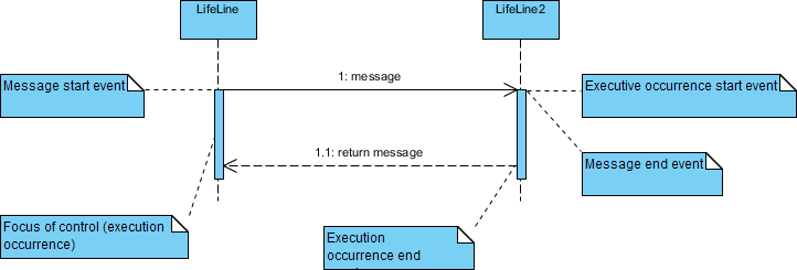

A focus of control, also known as the Activation bar, illustrates the period an object is acting. Actions can either be performed directly by an object or through a subordinate object to which it has sent messages.
Sequence Diagram notation: Flow of control and messages

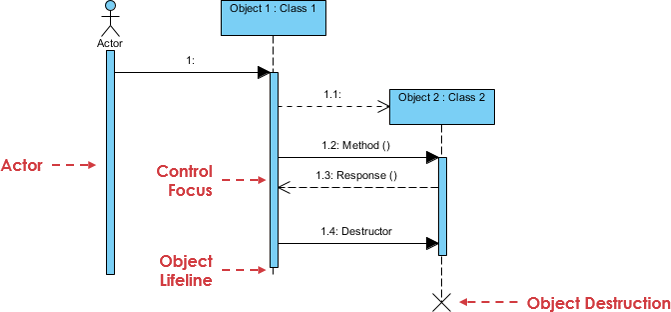

Participants do not necessarily live for the entire duration of a sequence diagram’s interaction. Participants can be created and destroyed according to the messages that are being passed.
constructor message creates its receiver. The sender that already exists at the start of the interaction is placed at the top of the diagram. Targets that are created during the interaction by a constructor call are automatically placed further down the diagram.
Sequence Diagram notation: Constructor message
destructor message destroys its receiver. There are other ways to indicate that a target is destroyed during an interaction. Only when a target’s destruction is set to ‘after destructor’ do you have to use a destructor.
Sequence Diagram notation: Destructor message

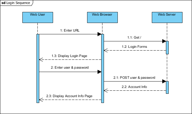

For example, a communication message interchanges between a user, a Web browser and a Web server to perform a user login process can be described as a communication message sequence with sequence frame.
Sequence Diagram notation: Frame

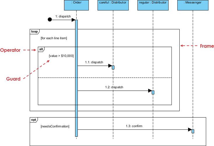

You can use sequence Fragments to add additional semantics to a sequence diagram.
  • UML 2.0 introduces sequence (or interaction) fragments. Sequence fragments make it easier to create and maintain accurate sequence diagrams
  • A sequence fragment is represented as a box, called a combined fragment, which encloses a portion of the interactions within a sequence diagram
  • The fragment operator (in the top left corner) indicates the type of fragment
  • Fragment types: ref, assert, loop, break, alt, opt, neg

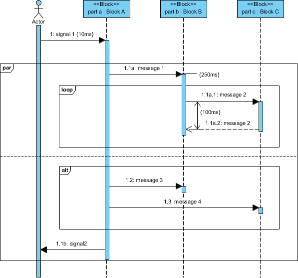

alt Alternative multiple fragments: only the one whose condition is true will execute.
opt Optional: the fragment executes only if the supplied condition is true. Equivalent to an alt only with one trace.
par Parallel: each fragment is run in parallel.
loop Loop: the fragment may execute multiple times, and the guard indicates the basis of iteration.
region Critical region: the fragment can have only one thread executing it at once.
neg Negative: the fragment shows an invalid interaction.
ref Reference: refers to an interaction defined in another diagram. The frame is drawn to cover the lifelines involved in the interaction. You can define parameters and return value.
sd Sequence diagram: used to surround an entire sequence diagram.
Sequence Diagram notation: Different fragment types

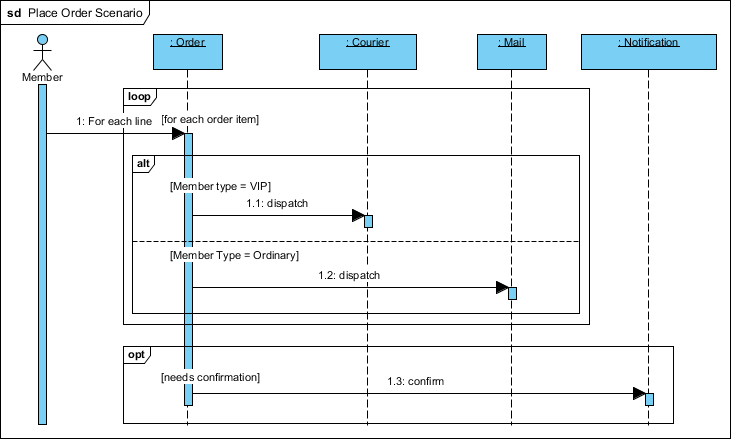

Sequence Fragment Example- Place Order Scenario
A member of a ship who would like to place an order online. The item ordered will be sent to the member either send by courier or by ordinary mail depending on the member status (VIP, Ordinary membership). Optionally, the shop will send the member a confirmation notice if the member opted for the notification option in the order.
Sequence Diagram Place Order example
