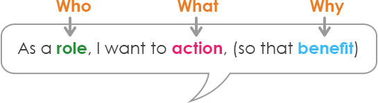

Here is a simple format of user story used by 70% of practitioners:
user story role action
Role – The user should be an actual human who interacts with the system.
  • Be as specific as possible
  • The development team is NOT a user
Action – The behavior of the system should be written as an action.
  • Usually unique for each User Story
  • The “system” is implied and does not get written in the story
  • Active voice, not passive voice (“I can be notified”)
Benefits – The benefit should be a real-world result that is non-functional or external to the system.
  • Many stories may share the same benefit statement.
  • The benefit may be for other users or customers, not just for the user in the story.

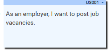

Card
Card represents 2-3 sentences used to describe the intent of the story that can be considered as an invitation to conversation. The card serves as a memorable token, which summarizes intent and represents a more detailed requirement, whose details remain to be determined.
You don’t have to have all of the Product Backlog Items written out perfectly “up front”, before you bring them to the team. It acknowledges that the customer and the team will be discovering the underlying business/system needed as they are working on it. This discovery occurs through conversation and collaboration around user stories. The Card is usually follows the format similar to the one below:
As a (role) of the product, I can (do action) so that I can obtain (some benefits / value)
Note:
  • The written text, the invitation to a conversation, must address the “who (role)“, “what (action)” and “why (benefits)” of the story.

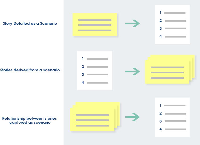

A scenario is a narrative, which describes how a user might interact with a website or software application which focuses on users’ needs rather than the technological aspects of design. It allows us to explore the user interaction in more detail, to describe the necessary steps and their relationship. It important as these enable usability experts and developers to get into the mindset of potential users. Another benefit of user scenarios is that they are written in a language that all team members should understand, regardless of specialism.
Roman Pichler (a leading scrum expert) suggested that, we can derive stories from a scenario, and we can also use a scenario to illustrate the relationship between different stories. The following diagram illustrates the three options:
scrum expert
