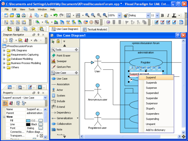

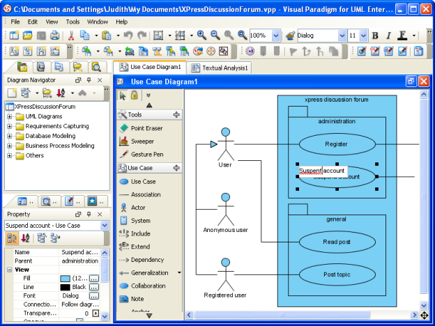

We may make typing or spelling mistakes during inline editing. Any potential incorrectness will be spotted and underlined with a wavy red line.
To correct this, right-click on the underlined word. This shows a list of suggested changes.

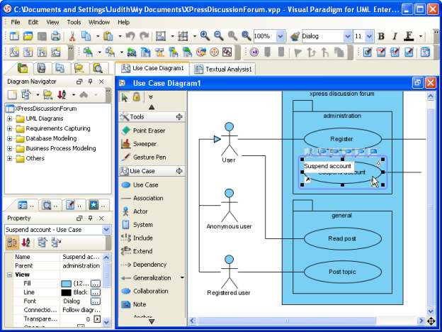

Select the correct one to change to, and editing can be continued after the correction has been made.

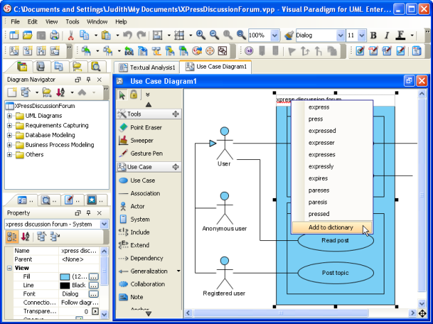

It is also possible to add new vocabulary to the dictionary. Right-click on the underlined word and select 'Add to Dictionary'. Once added to the dictionary the next occurrence of this word will not be identified as an error.

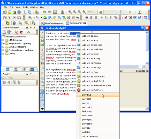

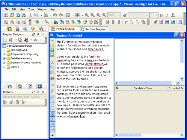

Spell checking is also available in Textual Analysis, and incorrect words written in the problem statement will be underlined. You can correct mistakes by using the pop-up menu.
This problem statement has several spelling mistakes.
This can be solved by right-clicking and using the pop-up menu.
