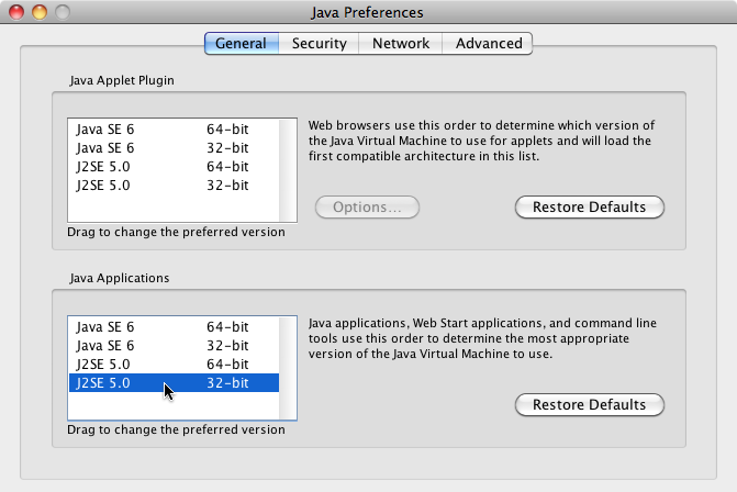

  5. Make "J2SE 5.0 32-bit" to be the default JVM for Java applications. Select J2SE 5.0 32-bit in the Java Applications list first.
    step 1
    Then drag it to the top of the list.
    step 2

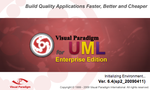

  6. Start VP-UML.
    start screen
