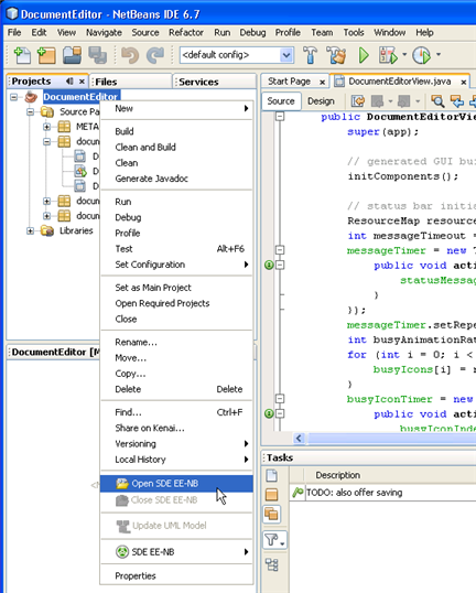

  5. Now, you have an empty Java project. Let's create a UML model from it. To create a UML model, right-click on the project root node in the Projects pane and select Open Visual Paradigm from the popup menu.
    4 open vp

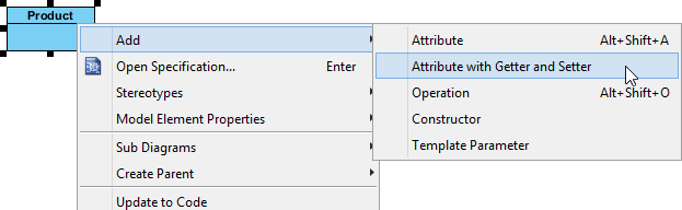

  7. A product has three attributes: name, partNo, and price. Let's add them. Right-click on the Product class and select Add > Attribute with Getter and Setter from the popup menu.
    7 class created
  8. Enter name : String to create the name attribute in String type. Then, press Enter to confirm. Right after your confirmation, the getter and setter operations for the name attribute will automatically be inserted into the class. Similarly, create two more attributes: partNo : String and price : float.
    8 create attributes

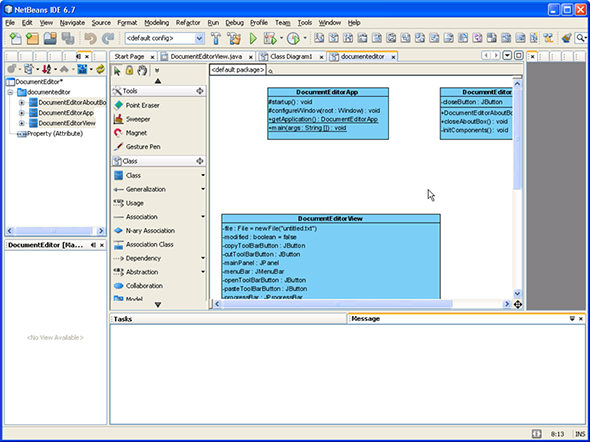

  7. Now, go to the Diagram Navigator. Click on the Update UML Model Element button to have your changes reflected in the UML model.
    6 update model
  8. Open the class diagram. The constructor method is presented in the Product class.
    7 generated constructor
  9. Switch to the Model Explorer pane. You can find the Vendor class inside the onlineshop package. Drag out the Vendor class and drop it onto the class diagram. The Vendor class will be visualized with an association with the Product class.
