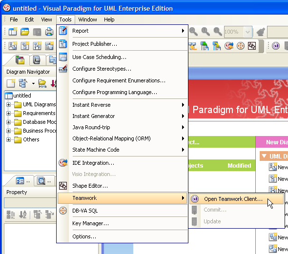

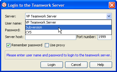

1. Select Tools > Teamwork > Open Teamwork Client... from the main menu.
This shows the Login to the Teamwork Server dialog box.

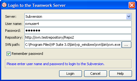

2. Select Subversion as Server
This expands the dialog box to show additional fields for connecting to the Subversion server.
3. Fill in all the fields to connect to the Subversion Server. You may need to contact the repository administrator for assistance in filling in the information.

Repository The path of the Subversion repository
SVN Path The path of the svn.exe file (The default is pointed to the svn.exe inside $vp-suite-install-dir/bin/vp_windows/svn/bin)

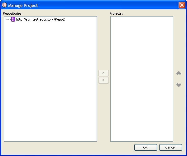

4. Press the Login button to connect to the server. This shows the Manage Project dialog box, which is for selecting a project file to work with.

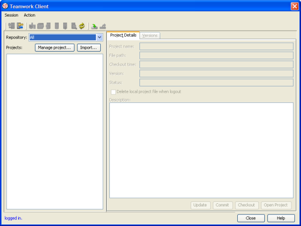

5. Press OK to skip this dialog box. This shows the Teamwork Client dialog box.

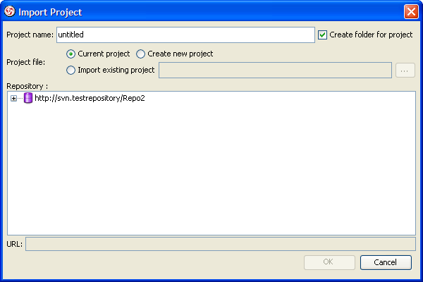

6. Press Import... This shows the Import Project dialog box.
7. Enter the project name of which to import.
8. Specify the source of the project to import to the Subversion server.
Option Description
Currently opened project The project that is opened in the running application
Create new project A blank and new Visual Paradigm project
Import existing project An external project file

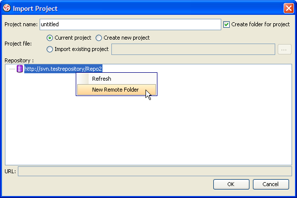

9. To create a remote folder to store the project in server, right-click on a tree node and select New Remote Folder from the pop-up menu.
If Create folder for project is checked, this will create a remote folder, which have the same name as the project file, for storing the project file.
10. Click OK when done.

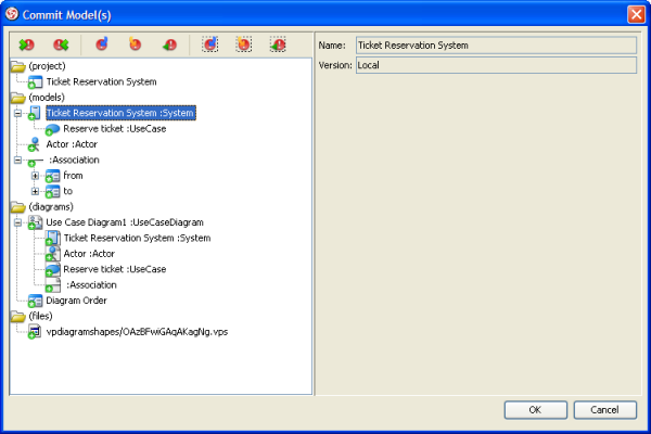

1. Click on the Commit button from the tool bar.
This shows the Commit Project dialog box.
2. Enter the description of the change and press OK.
This shows the Commit Model(s) dialog box, which list the changes that will be made to the server copy of the project.
A conflict might be found if someone else's committed change(s) cause conflict with the change(s) you made. You must resolve all the conflicts to proceed with committing the project. There are two ways of resolving a conflict, Overwrite and Revert. By Overwriting, the server version will be overwritten by the local version for that particular change. By Reverting, the server version will be selected.

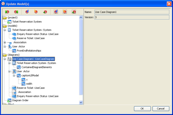

Updating a Project
The update project function updates the project by downloading changes made by other team members from the Teamwork Server to the client's computer.
1. Click on the Update button from the tool bar.
2. Press OK to proceed with updating the project.
