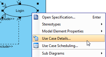

  5. We need to edit the test case of a use case. To do so, open the Use Case Details on use case Logic by right clicking on it and selecting Use Case Details from the popup menu.
    open use case details

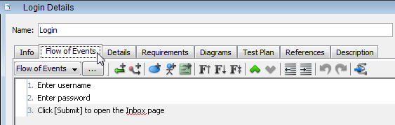

  6. Open the page of Flow of Events. The use case Logic is formed by a number of simple steps - enter username and passowrd, and click Submit. What we need to do is write test case to make sure this three steps will work as expected in the final product.
    open flow of events

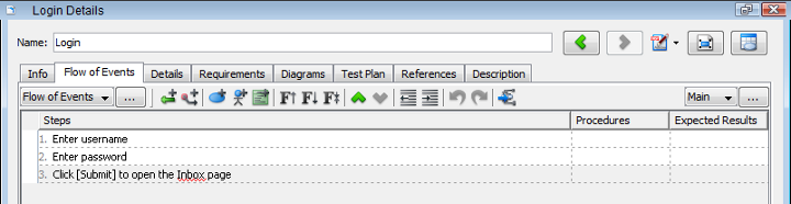

    Now, the flow of events page is divided into three columns - Steps, Procedures and Expected Results. By walking through the steps, the use case is said to be completed. Procedures and expected results are made for testing purposes. Procedures are the steps needed to test a step, while expected results are the outcome expected by performing the testing procedures.
    three cols

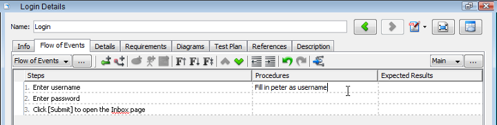

  8. We want to start by writing a valid test case. In step one, we shall test the entering of username by entering peter, assuming that peter is a valid and existing user, and expect to have name peter show on the username field. Enter Fill in peter as username in Procedures cell of step 1. There is no doubt that entering text in a field will have the text appear on the field, so we simply omit expected results here. If you like you can still enter Text "peter" show in username field, but just look a bit cumbersome.
    enter proc step1

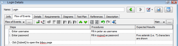

  9. For step two Enter password, specify Fill in mypwd as password in Procedures cell. In order to make sure a proper password field is used, we need to specify the expected results by entering Five asterisk (i.e. *) characters are shown in Expected Results cell.
    enter proc step2

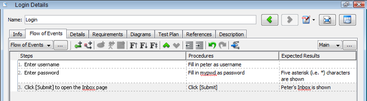

  10. For step three, specify Click [Submit] in Procedures cell. Enter Peter's Inbox is shown in expected results.
    enter proc step3

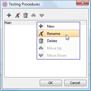

  12. In the Testing Procedures dialog box, right click Main and select Rename from the popup menu. Enter Logic with valid username and password as name.
    rename main

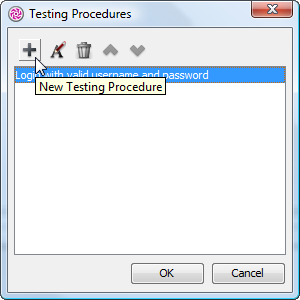

  13. Let's add another test case for testing invalid usage. In the Testing Procedures dialog box, click on the + button, enter Logic without username and password as name. Confirm the changes and go back to the page of flow of events.
    new testing procedures
