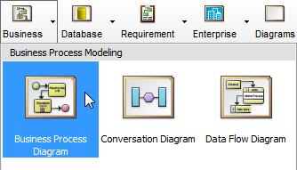

  4. Create a business process diagram (BPD) via the toolbar.
    new bpd

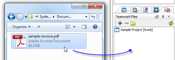

  8. Drag sample-invoice.pdf from file manager to the Teamwork Files pane in Agilian.
    drag files
  9. Click OK when you are asked to confirm putting the file to workspace. You must click OK here. If not, the file won't be added as a teamwork file nor committed to server.

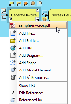

  5. Move the mouse pointer over the task Generate Invoice. Click on the References resource icon and select sample-invoice.pdf from the popup menu.
    open ref file
    This should open the PDF file. As you can see, you do not need to copy the file manually. Agilian has done it for you during the commit process.
