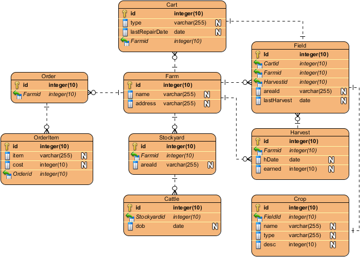

  4. Open Entity Relationship Diagram1 and take a look.
    database design

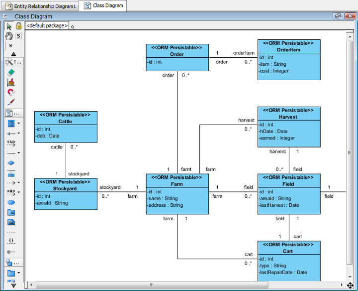

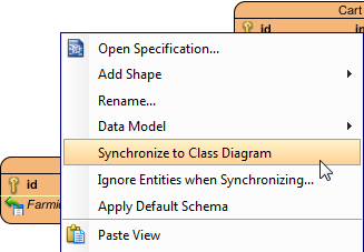

  5. Right click on the diagram background and select Synchronize to Class Diagram from popup menu.
    sync to class diagram
  6. Click OK in Synchronize from Entity Relationship Diagram to Class dialog box.
  7. Click OK in Synchronize to Class Diagram dialog box. This produce a class diagram.
    class diagram formed

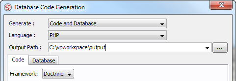

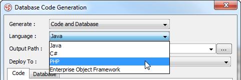

  9. In the Database Code Generation window, select PHP to be the language of code to generate.
    select PHP language
  10. Specify the output path of code files to be generated.
    set output path

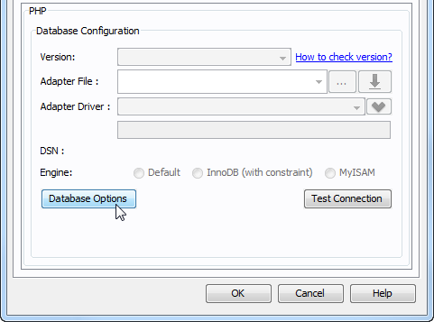

  11. Switch to the Database tab. Click Database Options at the bottom of dialog box.
    click database options

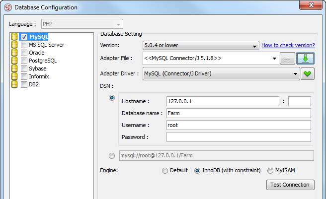

  12. Select MySQL at the database tree at the left hand side. Click on the down arrow button next to the Adapter File field to download the adapter for connecting to MySQL. Enter the hostname, database name, user name and password. Check InnoDB (with constraint). Click OK to confirm the changes.
    db configure

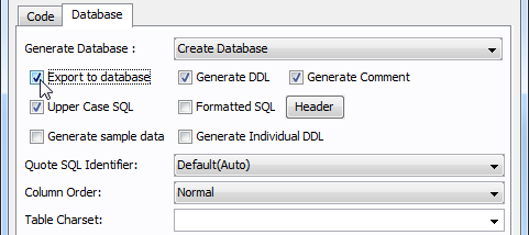

  13. Check Export to database. By checking this option, changes will be updated to database.
    export to db

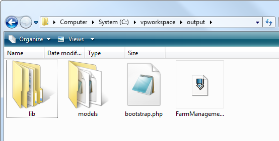

  15. Visit the output folder.
    generated files

written by michele on July 20, 2011
Hi, at the 9 step if I go on language select, I have only Java but no Php....Why? How can I do?
written by Jick Yeung on July 20, 2011
Hi michele,
You are probably running the Java edition of DB Visual ARCHITECT. Please run "VP Suite Product Edition Manager.exe" in the bin folder of VP Suite installation directory and change the product edition to either Professional or PHP Edition. They both support PHP.
Best regards,
Jick Yeung
I have already selected Professional edition, and in the select there is anyithing like php-edition...
Hi michele,
I am so sorry about this. I will check with our developers and get back to you as soon as possible.
Best regards,
Jick Yeung
Hi michele,
Please do this first:
1. Select "Tools > Object Relational Mapping > Database Configuration"
2. Select PHP for language selection.
I will also ask our team to allow direct language selection in the generation window. Sorry for any inconveniences it might have caused.
Best regards,
Jick Yeung
I have not solved. When I go on
On the Selection language I have only:
- java
- enterprise object framework
There is not Php.....What can be?
the solution is that php is supported for the enteriprise version and not for the professional!
written by Jick Yeung on July 21, 2011
Hi michele,
You are running VP-UML, not DB-VA. This tutorial was written for DB-VA. For DB-VA, there is no Enterprise Edition. The highest edition is Professional Edition. It supports PHP, .NET, Java.
If you are evaluating, please run the VP Suite.exe in the bin folder and install DB Visual ARCHITECT.
Best regards,
Jick Yeung
