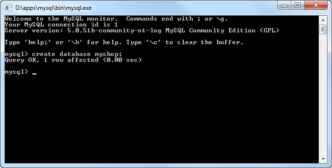

Create a database and name it myshop in advance.
create db

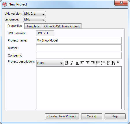

Create a new project by selecting Project > New from the application toolbar. In the New Project window, enter My Shop Model as the project name and click Create Blank Project.
new project

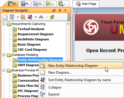

  1. Create an ERD. Right-click on Entity Relationship Diagram in Diagram Navigator and select New Entity Relationship Diagram from the pop-up menu.
    new erd

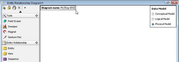

  2. Immediately, name the diagram MyShop ERD at the top left corner. Keep Physical Model selected at the top right corner.
    diagram name

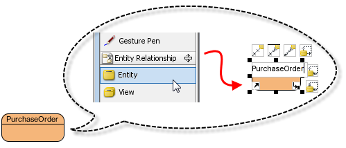

  3. Next, create an entity. Click on Entity on the diagram toolbar and drag to the diagram. Name it PurchaseOrder and press Enter to confirm.
    create purchase order

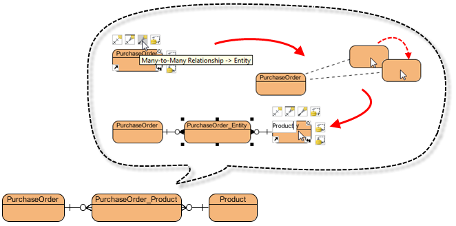

  4. A purchase order consists of many products, while a product can appear in many purchase orders. This is a typical example of a many-to-many relationship. Now, create the product entity. Move the mouse pointer to the entity PurchaseOrder, click on the resource icon Many-to-Many Relationship -> Entity, drag it out, and then release the mouse button to confirm. Name the entity Product.
    create product

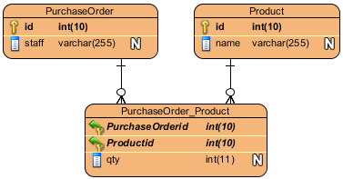

    The result of the diagram is shown below:
    completed erd

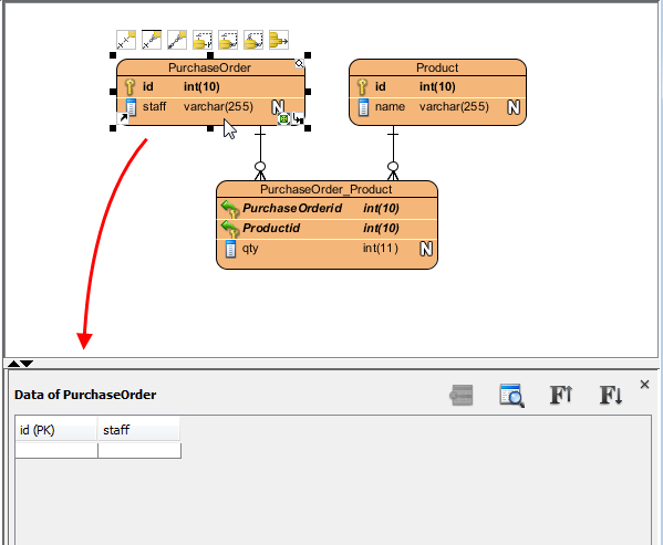

  1. Select PurchaseOrder. You can see the table record editor appears at the bottom of the diagram listing the columns for you to add default data. If you do not see the editor, right-click on the ERD's background and select Show Table Record Editor from the pop-up menu.
    record editor

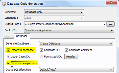

  1. Select Tools > Object-Relational Mapping (ORM) > Generate Database... from the main menu.
  2. In the Database Code Generation dialog box, check Export to database and Generate sample data. If you do not select them, both the database and sample data will not be created in the database.
    check option in db gen
  3. Click the OK button to start generation.

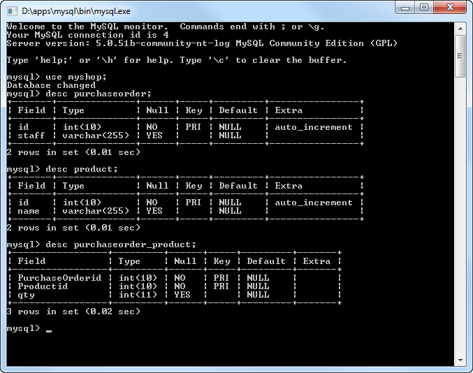

Checking Your Database
You can now check your database to see if the schema and default data are both generated. Here is a screenshot captured under MySQL, for checking the generated schema.
check schema

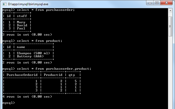

This is another screen that shows the default records added to the database.
check data
