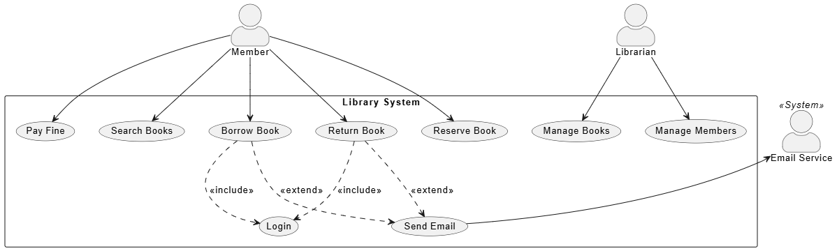

Step 6: Use Case Diagram
@startuml Library System - Minimal
' Minimal Styling
skinparam actorStyle awesome
skinparam defaultFontSize 13
' System
rectangle "Library System" {
    usecase"Search Books"
    usecase"Borrow Book"
    usecase"Return Book"
    usecase"Reserve Book"
    usecase "Pay Fine"
    usecase "Manage Books"
    usecase "Manage Members"
    usecase "Login" as Login
    "Borrow Book" ..> Login : <<include>>
    "Return Book" ..> Login : <<include>>
    usecase "Send Email" as Email
    "Borrow Book" ..> Email : <<extend>>
    "Return Book" ..> Email : <<extend>>
' Actors
actor"Member"
actor "Librarian"
actor "Email Service" as EmailSvc <<System>>
' Connections
Member --> "Search Books"
Member --> "Borrow Book"
Member --> "Return Book"
Member --> "Reserve Book"
Member --> "Pay Fine"
Librarian --> "Manage Books"
Librarian --> "Manage Members"
EmailSvc <-- Email
@enduml

After identifying actors and use cases:
  1. Create use case diagrams
  2. Write detailed use case specifications
  3. Derive system requirements
  4. Plan testing strategies
  5. Estimate development effort
