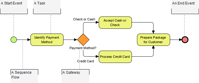

A BPD has a small set of (three) core elements, which are the Flow Objects so that modelers do not have to learn and recognize a large number of different shapes. The three Flow Objects are:
Event
An Event is represented by a circle and is something that “happens” during the course of a business process. These Events affect the flow of the process and usually have a cause (trigger) or an impact (result). Events are circles with open centers to allow internal markers to differentiate different triggers or results. There are three types of Events, based on when they affect the flow: Start, Intermediate, and End (see the figures to the right, respectively).
Activity
An Activity is represented by a rounded-corner rectangle (see the figure to the right) and is a generic term for work that the company performs. An Activity can be atomic or nonatomic (compound). The types of Activities are Task and Sub-Process. The Sub-Process is distinguished by a small plus sign in the bottom center of the shape.
Gateway

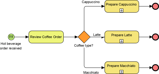

A Gateway is represented by the familiar diamond shape
and is used to control the divergence and convergence of Sequence Flow. Thus, it will determine traditional decisions, as well as the forking, merging, and joining of paths. Internal Markers will indicate the type of behavior control.
| Exclusive Gateway
Follow only one path |

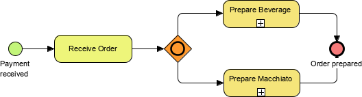

| Inclusive
Follow one or more paths |
| Parallel
Follow all paths |

Sequence Flow
A Sequence Flow is represented by a solid line with a solid arrowhead (see the figure to the right) and is used to show the order (the sequence) that activities will be performed in a Process. Note that the term “control flow” is generally not used in BPMN.

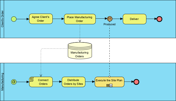

Many process modeling methodologies utilize the concept of swimlanes as a mechanism to organize activities into separate visual categories in order to illustrate different functional capabilities or responsibilities. BPMN supports swimlanes with two main constructs.
The two types of BPD swimlane objects are:
Pool – A Pool represents a Participant in a Process. It also acts as a graphical container for partitioning a set of activities from other Pools (see the figure to the right), usually in the context of B2B situations.
Lane – A Lane is a sub-partition within a Pool and will extend the entire length of the Pool, either vertically or horizontally (see the figure to the right). Lanes are used to organize and categorize activities.

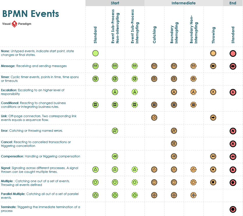

As I mentioned above, within the basic categories of elements, additional variation and information can be added to support the requirements for complexity without dramatically changing the basic look-and-feel of the diagram.
The event table below shows the complete combination of how events can be represented by using the basic element with an additional variation. BPMN events now can support for complexity without changing the basic look & feel of the notation:
