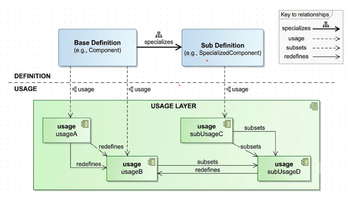

3. Structural Key Relationships
The core of the reference diagram outlines how definitions and usages interact in SysML v2. Your working code implements these exact principles:
  [ Definition ]  ────────── (specializes) ──────────►  [ SubDef ]
  (e.g., Component)                                   (e.g., SpecializedComponent)
       (usage)                                             (usage)
     [ usage ]    ◄─── (subsets) / (redefines) ───────   [ subUsage ]
Definition vs. Usage
Definition: A reusable blueprint or template. It does not exist as a physical object yet.
Code example: part def ElectricVehicle; (The generic blueprint for all such vehicles).
Usage: A specific occurrence, instance, or component part generated from that blueprint.
Code example: part battery : Battery; (A specific instance named battery that is built from the blueprint Battery).
The 5 Graph Relationships
Your code sets up the foundation to use all five relational pathways from the diagram:
  1. Definition → usage (:): Establishing an instance from a blueprint.
    • Example: part motor : ElectricMotor; binds a structural usage to its type definition.
  2. Definition → SubDef (specializes): Creating a child blueprint from a parent blueprint.
    • Example: If you created part def PerformanceEV specializes ElectricVehicle;, the new definition inherits all parts (battery, motor) and behaviors (accelerate) from the parent definition.
  3. SubDef → subUsage (usage 🙂: Instantiating a component from a specialized sub-definition.
    • Example: A specialized car would contain a specialized sub-usage component inside it.
  4. subUsage → usage (subsets :>): Indicating that a specific collection of instances is part of a broader parent collection.
  5. subUsage → usage (redefines :>>): Completely replacing or refining an inherited parent usage with a specialized sub-usage.
    • Example: If a PerformanceEV needs a HighOutputMotor instead of the standard base motor, you would declare: part highOutputMotor : HighOutputMotor redefines motor;. This satisfies both subsets and redefines simultaneously.

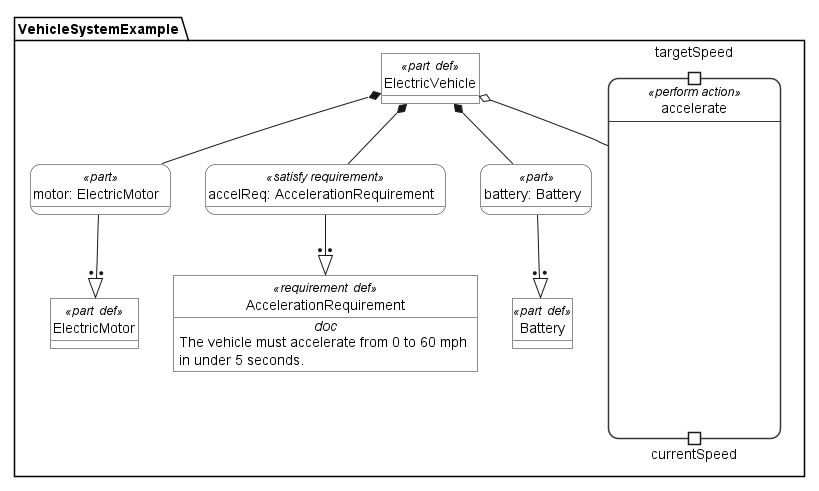

package VehicleSystemExample {
    // 1. REQUIREMENT PILLAR (Problem Space)
    requirement def AccelerationRequirement {
        doc /* The vehicle must accelerate from 0 to 60 mph in under 5 seconds. */
    // 2. STRUCTURE PILLAR (Solution Space)
    part def ElectricVehicle {
        // Structural components (parts)
        // Satisfying the requirement structurally
        satisfy requirement accelReq : AccelerationRequirement;
        // 3. BEHAVIOR PILLAR (Execution)
        perform action accelerate {
            in targetSpeed;
            out currentSpeed;
