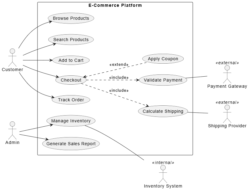

Example - E-Commerce Platform:
PlatnUML Use Case Diagram:
@startuml
left to right direction
skinparam packageStyle rectangle
actor "Customer" as Customer
actor "Admin" as Admin
actor "Payment Gateway" as PG <<external>>
actor "Shipping Provider" as SP <<external>>
actor "Inventory System" as IS <<internal>>
rectangle "E-Commerce Platform" {
usecase "Browse Products" as UC1
usecase "Search Products" as UC2
usecase "Add to Cart" as UC3
usecase "Checkout" as UC4
usecase "Validate Payment" as UC5
usecase "Calculate Shipping" as UC6
usecase "Apply Coupon" as UC7
usecase "Track Order" as UC8
usecase "Manage Inventory" as UC9
usecase "Generate Sales Report" as UC10
Customer --> UC1
Customer --> UC2
Customer --> UC3
Customer --> UC4
Customer --> UC8
Admin --> UC9
Admin --> UC10
UC4 ..> UC5 : <<include>>
UC4 ..> UC6 : <<include>>
UC4 <.. UC7 : <<extend>>
UC5 -- PG
UC6 -- SP
UC9 -- IS
@enduml
Design Insights:
  • Identifies need for payment validation service
  • Reveals dependency on external shipping API
  • Shows admin vs. customer functionality separation
  • Highlights reusable components (Validate Payment)
