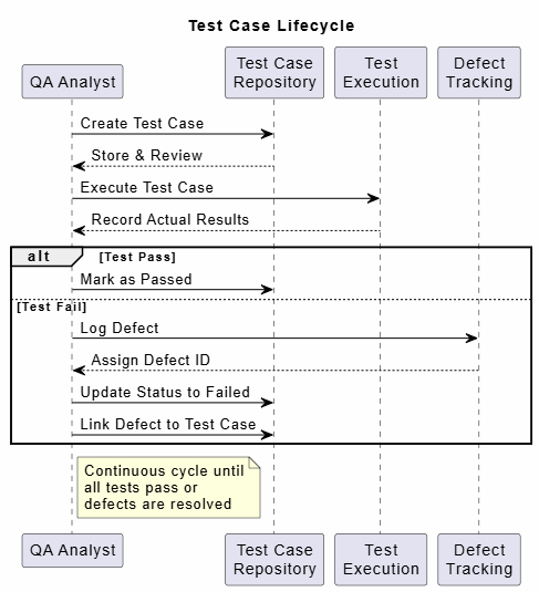

PlantUML Diagram: Test Case Lifecycle
@startuml
title Test Case Lifecycle
skinparam backgroundColor #FEFEFE
skinparam sequence {
  ArrowColor Black
  ActorBorderColor Black
  LifeLineBorderColor black
  LifeLineBackgroundColor #EFFFFF
participant "QA Analyst" as QA
participant "Test Case\nRepository" as TC
participant "Test\nExecution" as TE
participant "Defect\nTracking" as DT
QA -> TC: Create Test Case
TC --> QA: Store & Review
QA -> TE: Execute Test Case
TE --> QA: Record Actual Results
alt Test Pass
  QA -> TC: Mark as Passed
else Test Fail
  QA -> DT: Log Defect
  DT --> QA: Assign Defect ID
  QA -> TC: Update Status to Failed
  QA -> TC: Link Defect to Test Case
end
note right of QA
  Continuous cycle until
  all tests pass or
  defects are resolved
end note
@enduml

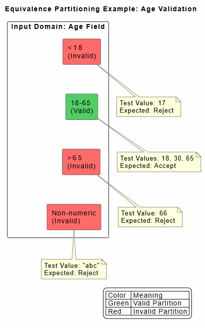

4.1 Equivalence Partitioning (EP)
Concept: Divide input data into partitions where all values in a partition are expected to behave the same way. Test one value from each partition.
When to Use: When input has defined ranges or categories
Example: Age Validation Field
Scenario: System accepts age between 18 and 65 (inclusive)
Partitions:
  • Valid Partition: 18-65
  • Invalid Partition 1: < 18 (e.g., 17)
  • Invalid Partition 2: > 65 (e.g., 66)
  • Invalid Partition 3: Non-numeric (e.g., "abc")
Test Case ID: TC_EP_001
Title: Validate Age Field Using Equivalence Partitioning
Technique: Equivalence Partitioning
Test Cases:
1. TC_EP_001a: Enter age = 30 (Valid partition)
   Expected: Accept input; proceed to next field
2. TC_EP_001b: Enter age = 17 (Invalid - below range)
   Expected: Display error "Age must be between 18 and 65"
3. TC_EP_001c: Enter age = 66 (Invalid - above range)
4. TC_EP_001d: Enter age = "abc" (Invalid - non-numeric)
   Expected: Display error "Please enter a valid number"
PlantUML: Equivalence Partitioning Visualization
@startuml
title Equivalence Partitioning Example: Age Validation
rectangle "Input Domain: Age Field" {
  rectangle "<18\n(Invalid)" as inv1 #FF6B6B
  rectangle "18-65\n(Valid)" as valid #51CF66
  rectangle ">65\n(Invalid)" as inv2 #FF6B6B
  rectangle "Non-numeric\n(Invalid)" as inv3 #FF6B6B
  inv1 -[hidden]- valid
  valid -[hidden]- inv2
  inv2 -[hidden]- inv3
note bottom of inv1
  Test Value: 17
  Expected: Reject
end note
note bottom of valid
  Test Values: 18, 30, 65
  Expected: Accept
end note
note bottom of inv2
  Test Value: 66
  Expected: Reject
end note
note bottom of inv3
  Test Value: "abc"
  Expected: Reject
end note
legend right
  | Color | Meaning |
  | Green | Valid Partition |
  | Red | Invalid Partition |
endlegend
@enduml

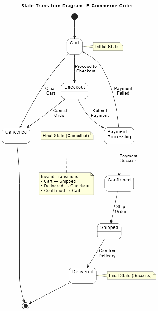

4.4 State Transition Testing
Concept: Tests system behavior when transitioning between different states. Useful for systems with distinct states and defined transitions.
When to Use: Workflow systems, order processing, user sessions
Example: E-Commerce Order Status
States: Cart → Checkout → Payment Processing → Confirmed → Shipped → Delivered
Valid Transitions:
  • Cart → Checkout
  • Checkout → Payment Processing
  • Payment Processing → Confirmed (success) or Cart (failure)
  • Confirmed → Shipped
  • Shipped → Delivered
Invalid Transitions:
  • Cart → Shipped (skip steps)
  • Delivered → Checkout (reverse flow)
Test Case ID: TC_ST_001
Title: Order Status State Transition Testing
Technique: State Transition Testing
Test Cases:
1. TC_ST_001_ValidFlow: Complete valid order flow
   Steps:
     - Add item to cart (State: Cart)
     - Proceed to checkout (Transition: Cart→Checkout)
     - Enter payment details (State: Checkout)
     - Submit payment (Transition: Checkout→Payment Processing)
     - Payment succeeds (Transition: Payment Processing→Confirmed)
     - Order ships (Transition: Confirmed→Shipped)
     - Order delivered (Transition: Shipped→Delivered)
   Expected: All transitions successful; final state = Delivered
2. TC_ST_001_PaymentFailure: Test payment failure transition
   Steps:
     - Reach Payment Processing state
     - Payment fails
     - System returns to Cart
   Expected: State transitions back to Cart; items remain in cart
3. TC_ST_001_InvalidTransition: Attempt invalid transition
   Steps:
     - Item in Cart
     - Try to mark as Shipped directly
   Expected: System rejects transition; error message displayed
4. TC_ST_001_CancelOrder: Cancel during checkout
   Steps:
     - In Checkout state
     - Click 'Cancel Order'
   Expected: Return to Cart; order not created
PlantUML: State Transition Diagram
@startuml
title State Transition Diagram: E-Commerce Order
skinparam state {
  BackgroundColor White
  BorderColor Black
state "Cart" as cart
state "Checkout" as checkout
state "Payment\nProcessing" as payment
state "Confirmed" as confirmed
state "Shipped" as shipped
state "Delivered" as delivered
state "Cancelled" as cancelled
[*] --> cart
cart --> checkout : Proceed to\nCheckout
checkout --> payment : Submit\nPayment
payment --> confirmed : Payment\nSuccess
payment --> cart : Payment\nFailed
confirmed --> shipped : Ship\nOrder
shipped --> delivered : Confirm\nDelivery
checkout --> cancelled : Cancel\nOrder
cart --> cancelled : Clear\nCart
cancelled --> [*]
delivered --> [*]
note right of cart
  Initial State
end note
note right of delivered
  Final State (Success)
end note
note right of cancelled
  Final State (Cancelled)
end note
' Highlight invalid transitions
note bottom
  • Cart → Shipped
  • Confirmed → Cart
end note
@enduml

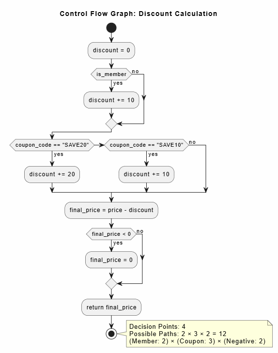

5.3 Path Coverage
Concept: Test all possible paths through the code. Most thorough but often impractical for complex code.
Note: Number of paths can grow exponentially with loops and nested conditions.
PlantUML: Control Flow for Coverage Analysis
@startuml
title Control Flow Graph: Discount Calculation
start
:discount = 0;
if (is_member) then (yes)
  :discount += 10;
else (no)
endif
if (coupon_code == "SAVE20") then (yes)
  :discount += 20;
elseif (coupon_code == "SAVE10") then (yes)
  :discount += 10;
else (no)
endif
:final_price = price - discount;
if (final_price < 0) then (yes)
  :final_price = 0;
else (no)
endif
:return final_price;
stop
note right
  Decision Points: 4
  Possible Paths: 2 × 3 × 2 = 12
  (Member: 2) × (Coupon: 3) × (Negative: 2)
end note
@enduml
