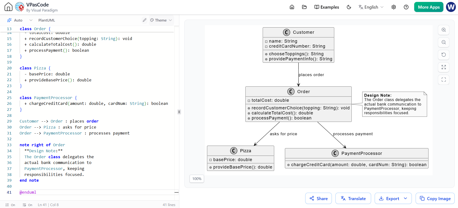

1. Class Diagram: The Final Structure
This diagram shows the final classes, their attributes (data they know), and their methods (what they do), based directly on our CRC cards.
@startuml
skinparam monochrome true
skinparam classFontSize 14
skinparam noteFontSize 12
class Customer {
  - name: String
  - creditCardNumber: String
  + chooseToppings(): String
  + providePaymentInfo(): String
class Order {
  - totalCost: double
  + recordCustomerChoice(topping: String): void
  + calculateTotalCost(): double
  + processPayment(): boolean
class Pizza {
  - basePrice: double
  + provideBasePrice(): double
class PaymentProcessor {
  + chargeCreditCard(amount: double, cardNum: String): boolean
Customer --> Order : places order
Order --> Pizza : asks for price
Order --> PaymentProcessor : processes payment
note right of Order
  **Design Note:**
  The Order class delegates the
  actual bank communication to
  PaymentProcessor, keeping
  responsibilities focused.
end note
@enduml

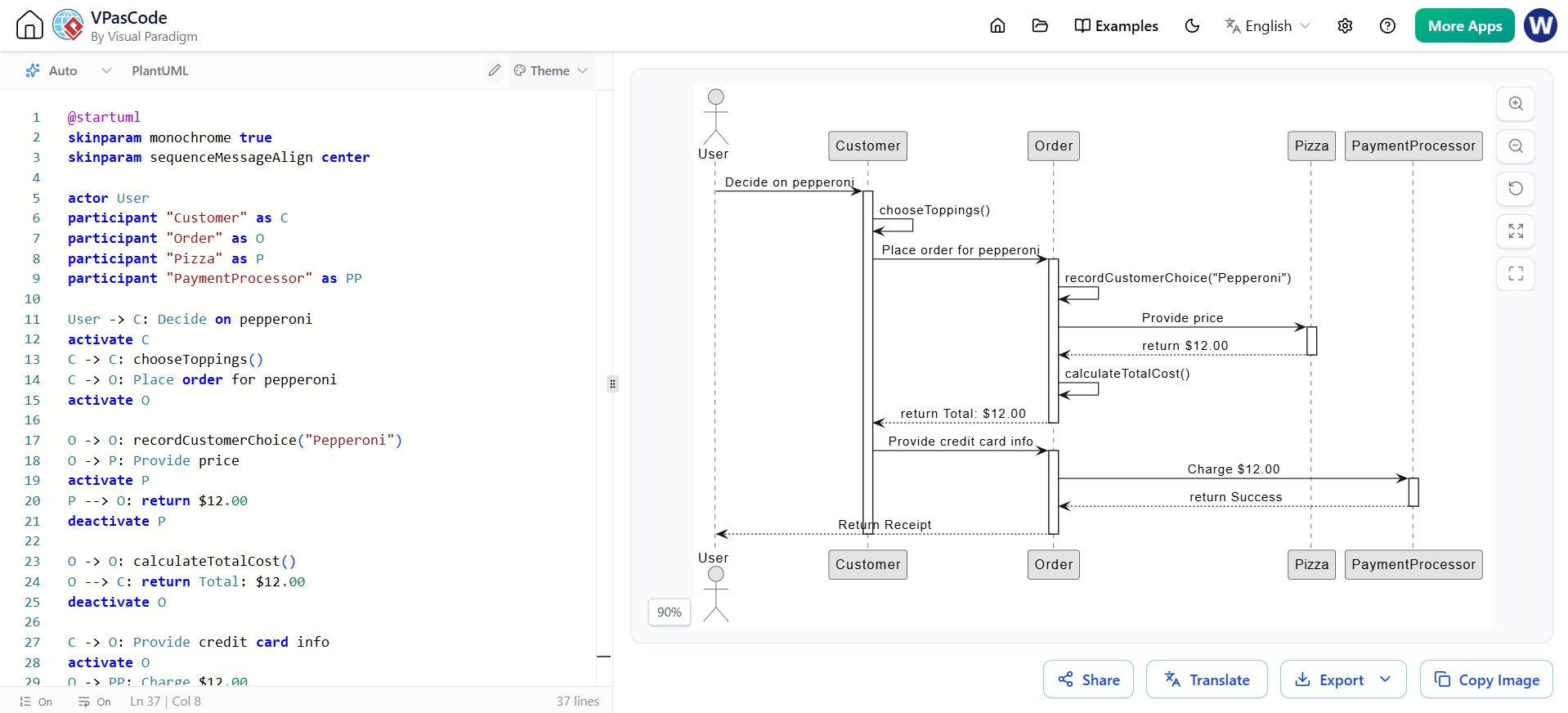

2. Sequence Diagram: The Role-Play in Action
This diagram shows the exact flow of messages during our pizza ordering scenario, proving that the objects collaborate correctly.
@startuml
skinparam sequenceMessageAlign center
actor User
participant "Customer" as C
participant "Order" as O
participant "Pizza" as P
participant "PaymentProcessor" as PP
User -> C: Decide on pepperoni
activate C
C -> C: chooseToppings()
C -> O: Place order for pepperoni
activate O
O -> O: recordCustomerChoice("Pepperoni")
O -> P: Provide price
activate P
P --> O: return $12.00
deactivate P
O -> O: calculateTotalCost()
O --> C: return Total: $12.00
deactivate O
C -> O: Provide credit card info
activate O
O -> PP: Charge $12.00
activate PP
PP --> O: return Success
deactivate PP
O --> User: Return Receipt
deactivate O
deactivate C
@enduml
