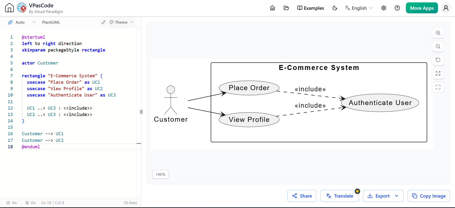

Include (Mandatory Common Behavior)
Use <<include>> to factor out common behavior that appears in multiple use cases into a separate, reusable unit. The included use case is mandatory for the base use case to complete.
  • Example: Both "Place Order" and "View Profile" require the user to be logged in. We extract "Authenticate User" and include it in both.
@startuml
left to right direction
skinparam packageStyle rectangle
actor Customer
rectangle "E-Commerce System" {
  usecase "Place Order" as UC1
  usecase "View Profile" as UC2
  usecase "Authenticate User" as UC3
  UC1 ..> UC3 : <<include>>
  UC2 ..> UC3 : <<include>>
Customer --> UC1
Customer --> UC2
@enduml

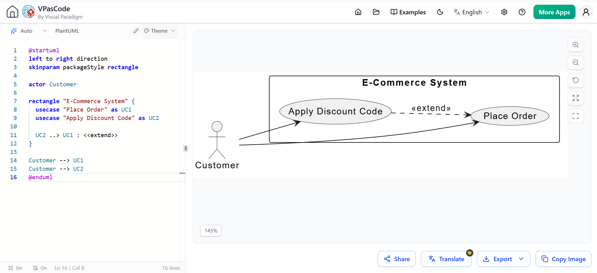

Extend (Optional or Conditional Behavior)
Use <<extend>> for optional behavior or actions that only occur under certain conditions. It is often used to move a complex alternate course into its own use case to keep the main use case clean.
  • Example: "Apply Discount Code" is not required to place an order, but if the user chooses to do it, it extends the "Place Order" use case.
@startuml
actor Customer
  usecase "Apply Discount Code" as UC2
  UC2 ..> UC1 : <<extend>>
Customer --> UC1
Customer --> UC2
@enduml

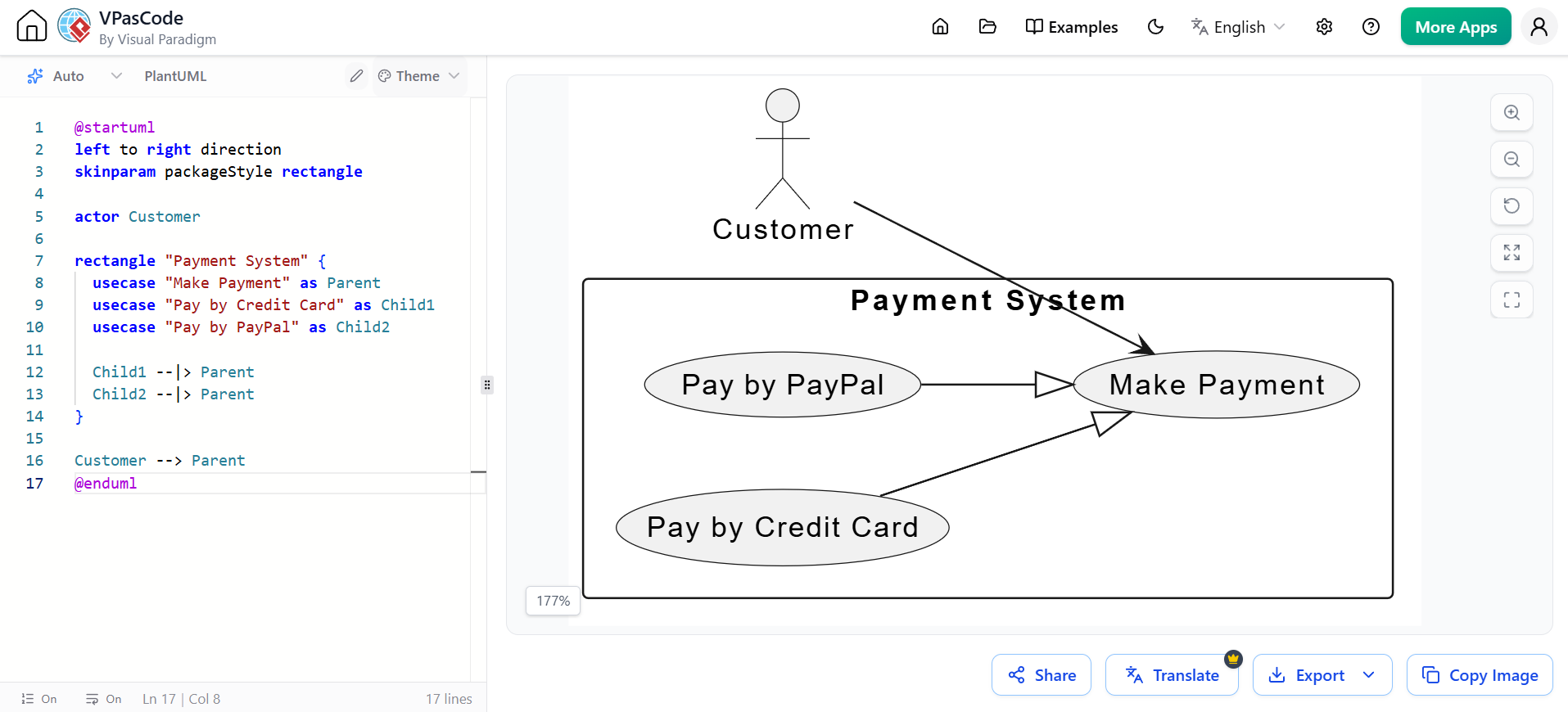

Generalization (Inheritance)
Similar to class generalization in object-oriented design, a parent use case can define common behavior that "child" use cases inherit and refine. The child use cases represent specific variations of the parent.
  • Example: "Make Payment" is the parent. "Pay by Credit Card" and "Pay by PayPal" are children that inherit the general payment flow but refine the specific steps.
@startuml
actor Customer
rectangle "Payment System" {
  usecase "Make Payment" as Parent
  usecase "Pay by Credit Card" as Child1
  usecase "Pay by PayPal" as Child2
  Child1 --|> Parent
  Child2 --|> Parent
Customer --> Parent
@enduml

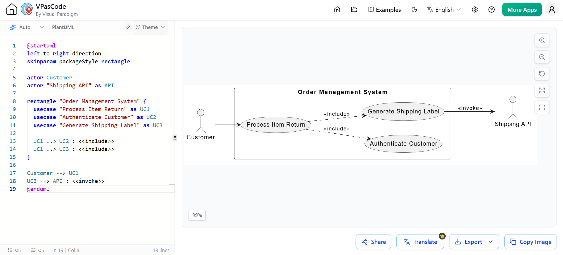

UML Diagram for "Process Item Return"
@startuml
actor Customer
actor "Shipping API" as API
rectangle "Order Management System" {
  usecase "Process Item Return" as UC1
  usecase "Authenticate Customer" as UC2
  usecase "Generate Shipping Label" as UC3
  UC1 ..> UC2 : <<include>>
Customer --> UC1
UC3 --> API : <<invoke>>
@enduml
