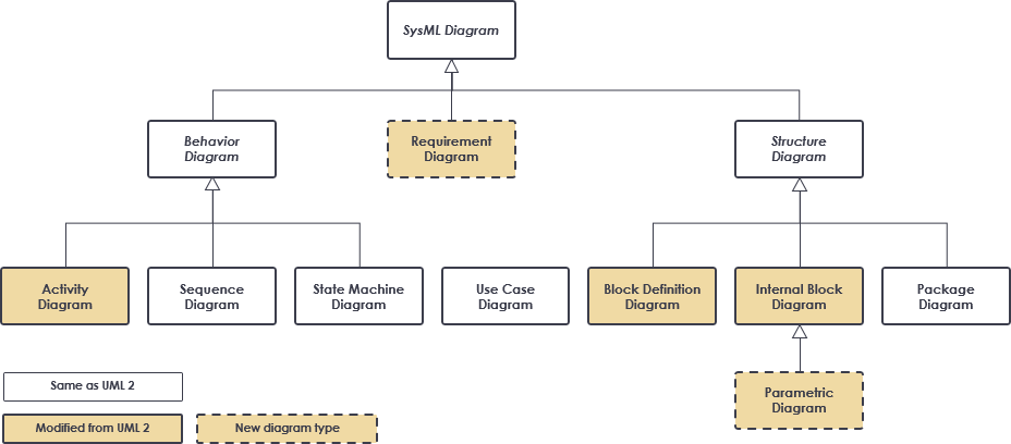

An activity diagram is a kind of behavior diagram; it’s a dynamic view of the system that expresses sequences of behaviors and event occurrences over time. In SysML, an activity diagram is inherited from UML with some minor modifications.
Activity diagrams, sequence diagrams, and state machine diagrams are the three options that SysML offers you to specify system behavior. All three can express sequential and concurrent behaviors and event occurrences over time. However, each one has strengths and weaknesses that make it more or less appropriate based on the needs of your target audience.

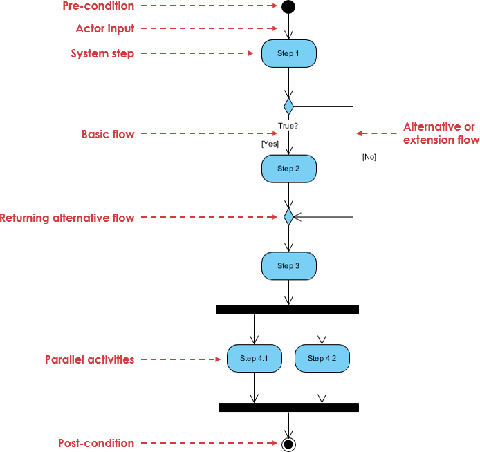

A basic activity diagram – flowchart like

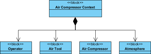

The Block Definition Diagram includes a block called the Air Compressor Context that is composed of the Air Compressor and the entities that are external to the Air Compressor representing the user (Operator), external system (Air Tool), and the physical environment (Atmosphere).
The Air Compressor and the external systems are shown as activity partitions.

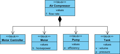

The Compress Air action is further decomposed. Now, let’s continue the Air Compressor example, we can use an internal block diagram below to show how the components of the Air Compressor are interconnected.
(*Source – Example extracted from – The Practical Guide to SysML 3rd ed by Morgan Kaufmann 2014)

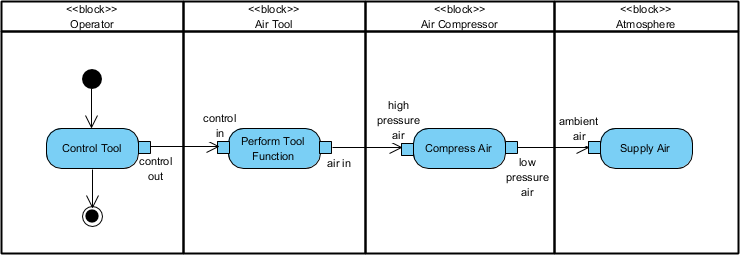

We can use the activity diagram to shows how the components interact within the Air Compressor when performing a compress Air action. The activity partitions in this activity diagram correspond to the four components of the air compressor as shown in the Swimlane Activity Diagram below:
(*Source – Example extracted from – The Practical Guide to SysML 3rd Ed by Morgan Kaufmann 2014)
The low-pressure air input and high-pressure air output are consistent with the input and output of the Compress Air action contained in the Behavior package along with the Operate Air Tool activity in the previous high-level activity diagram example.
