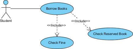

Include Relationship
The include relationship adds additional functionality not specified in the base use case. The <<Include>> relationship is used to include common behavior from an included use case into a base use case to support the reuse of common behavior.
Use Case Diagram notation: Include

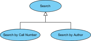

Generalization Relationship
A generalization relationship means that a child use case inherits the behavior and meaning of the parent use case. The child may add or override the behavior of the parent. The figure below provides a use case example by showing two generalization connectors that connect between the three use cases.
Use Case Diagram notation: Generalization

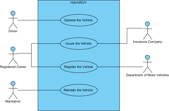

Top Level Use Cases
The use case diagram for “Drive Vehicle” in Figure 5 depicts the drive vehicle usage of the vehicle system. The subject (Hybrid SUV) and the actors (Driver, Registered Owner, Maintainer, Insurance Company, DMV) interact to realize the use case.
SysML Hybrid HSUV Use Case Diagram

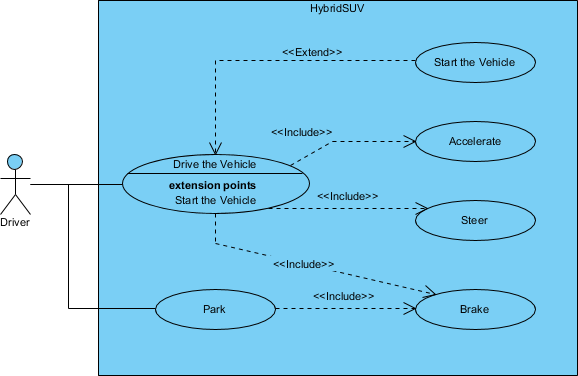

Operational Use Cases
Goal-level Use Cases associated with “Operate the Vehicle” are depicted in the following diagram. These use cases help flesh out the specific kind of goals associated with driving and parking the vehicle. Maintenance, registration, and insurance of the vehicle would be covered under a separate set of goal-oriented use cases.
SysML Use Case Diagram operational use cases

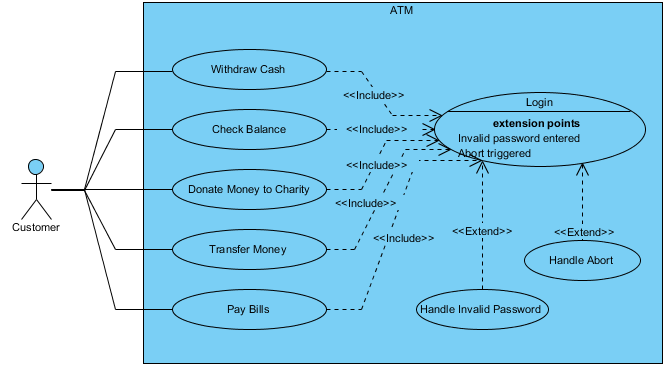

ATM example
Use Case Diagram: ATM example

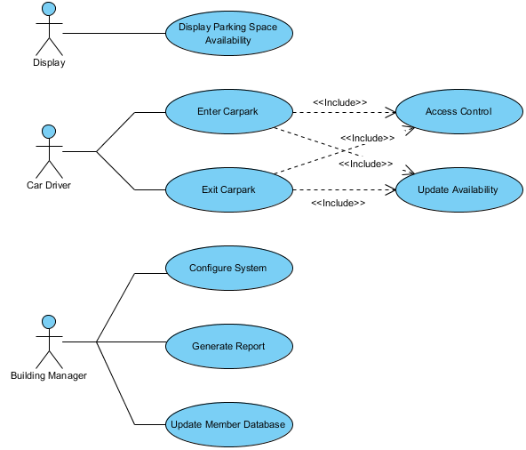

Carpark system
Use case Diagram example: Car park system
