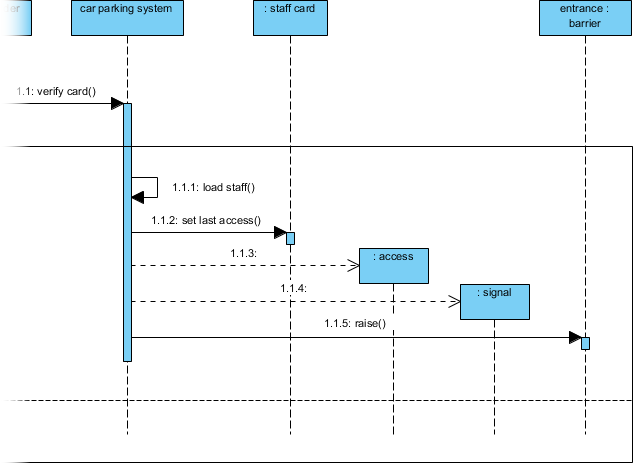

  15. Let’s say the last access time will be set to the record of staff card. Represent this by a set message set last access().
    Sequence message created
  16. A record of access would be created. Let’s visualize the access class on the diagram as a lifeline, and then connect to it with a create message. Don’t forget to enlarge the alternative combined fragment to cover the lifeline.
    Create message created
  17. A signal would also be created to trigger the barrier to raise. Let’s visualize the signal class on the diagram and then connect to it with a create message. Up to now, your sequence diagram should look similar to the figure below.
    Sequence diagram updated
  18. Raise the barrier. Visualize the barrier class as a lifeline and connect to it with a raise() message. Here we name the lifeline entrance because there is a barrier in at both the entrance and exit while we are referring to the one at entrance in this diagram.
    Barrier class visualized
  19. Finally, request the card reader to show a message to indicate the success verification of staff card. Create a sequence message show success message that connects between car parking system and : card reader.
    Show success message
