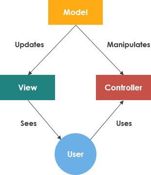

MVC (Model-View-Controller) is an architectural design pattern that encourages improved application organization through a separation of concerns. It divides an interactive application into three components: Model / View and Controller. It enforces the isolation of business data (Models) from user interfaces (Views), with a third component (Controllers) traditionally managing logic, user-input and coordinating both the models and views. The goal of MVC is to help structure the separate the concerns of an application into three parts:
  • Model is responsible for managing the data of the application. It receives user input from the controller.
  • View means the presentation of the model in a particular format.
  • Controller responds to the user input and performs interactions on the data model objects. The controller receives the input, optionally validates it and then passes the input to the model.
Model View and Controller

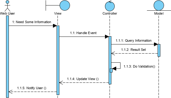

And here is the simplistic and hypothetical sequence diagram for MVC. What you see in this diagram, a web-user initiated a query and an event is generated that is handled by the controller and gets information that is needed from the model, validates the information and passes back the result set to the view.
MVC Sequence Diagram example

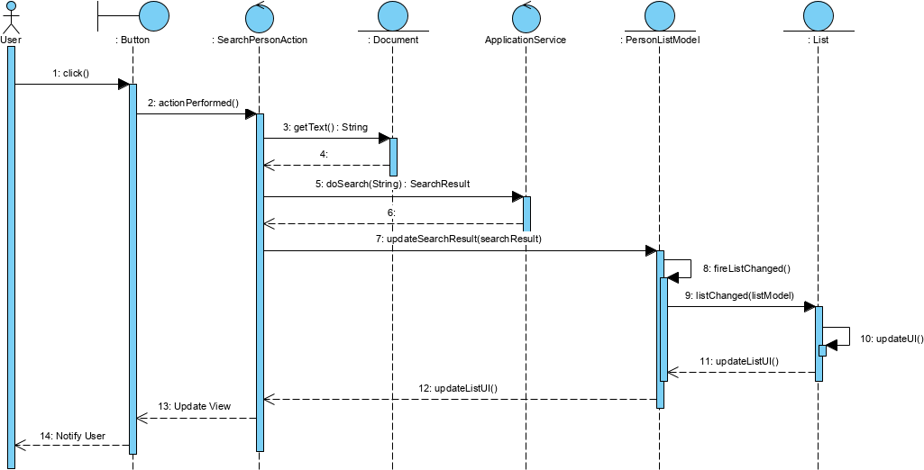

Suppose an application that let you search for persons. The UI must have a text field where the user can enter a search string and it might have a button to start the search. Finally it must have an area where the search results are displayed. In our case, it is implemented with a list component.
The “Search for Persons” use case Scenario is:
  • The user enters a search string in the text field
  • The user clicks the search button.
  • The search result is displayed in the result list.
MVC sequence diagram example
The sequence diagram above shows how the user’s button click moves through the application until the result gets finally displayed in the list component.
