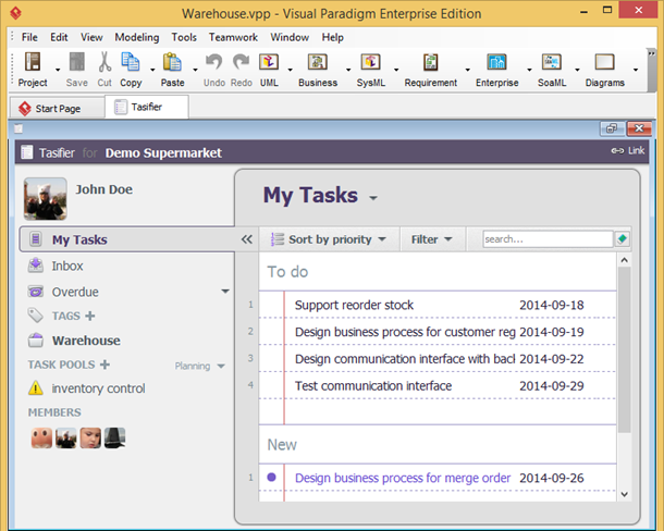

Tasifier, the task management platform is accessible from within Visual Paradigm. To open Tasifier, select Team > Tasifier from the main menu.
This opens Tasifier.

- As an assignee of tasks, Stephen can see a number of tasks listed in Tasifier.
 The tasks are listed under the New section by default. He can prioritize his work by moving the tasks to do next to the To do Now, drag the task Support querying stock level from the New list to the To do list.
