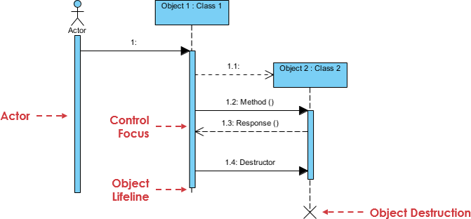

Creation and Destruction Messages
Participants do not necessarily live for the entire duration of a sequence diagram’s interaction. Participants can be created and destroyed according to the messages that are being passed.
A constructor message creates its receiver. The sender that already exists at the start of the interaction is placed at the top of the diagram. Targets that are created during the interaction by a constructor call are automatically placed further down the diagram.
Sequence Diagram notation: Constructor message
A destructor message destroys its receiver. There are other ways to indicate that a target is destroyed during an interaction. Only when a target’s destruction is set to ‘after destructor’ do you have to use a destructor.
Sequence Diagram notation: Destructor message

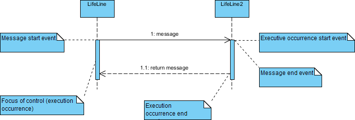

Non-instantaneous message
Messages are often considered to be instantaneous, thus, the time it takes to arrive at the receiver is negligible. The messages are drawn as a horizontal arrow. To indicate that it takes a certain while before the receiver receives a message, a slanted arrow is used.
Sequence Diagram notation: Non-instantaneous message

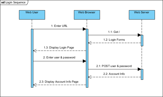

For example, a communication message interchanges between a user, a Web browser and a Web server to perform a user login process can be described as a communication message sequence with sequence frame.
Sequence Diagram notation: Frame

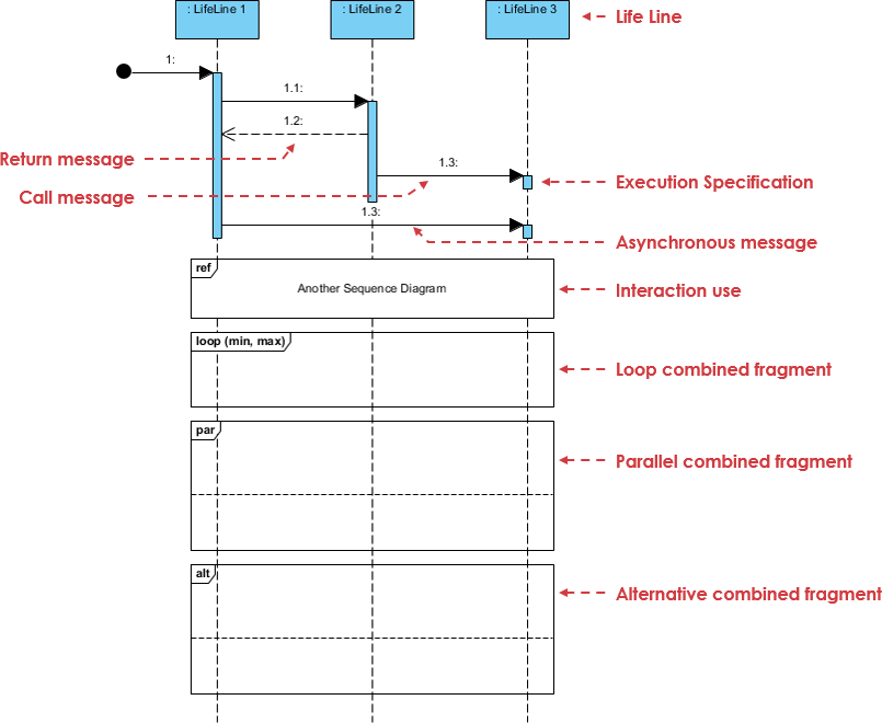

Sequence Diagram Fragments
You can use sequence Fragments to add additional semantics to a sequence diagram.
  • UML 2.0 introduces sequence (or interaction) fragments. Sequence fragments make it easier to create and maintain accurate sequence diagrams
  • A sequence fragment is represented as a box, called a combined fragment, which encloses a portion of the interactions within a sequence diagram
  • The fragment operator (in the top left corner) indicates the type of fragment
  • Fragment types: ref, assert, loop, break, alt, opt, neg
Modeling Simple Logic and Algorithms
A common issue with sequence diagrams is how to show looping and conditional behavior. The first thing to point out is that this isn’t what sequence diagrams are good at. If you want to show control structures like this, you are better off with an activity diagram or indeed with code itself. Treat sequence diagrams as a visualization of how objects interact rather than as a way of modeling control logic.
If you still prefer to model this in a sequence diagram, here’s the notation to use. Both loop and conditional use interaction frames, which are ways of marking off a piece of a sequence diagram. The sequence diagram example below shows a simple algorithm based on the following pseudocode:
Sequence Diagram notation: Fragment
alt Alternative multiple fragments: only the one whose condition is true will execute.
opt Optional: the fragment executes only if the supplied condition is true. Equivalent to an alt only with one trace.
par Parallel: each fragment is run in parallel.
loop Loop: the fragment may execute multiple times, and the guard indicates the basis of iteration.
region Critical region: the fragment can have only one thread executing it at once.
neg Negative: the fragment shows an invalid interaction.
ref Reference: refers to an interaction defined in another diagram. The frame is drawn to cover the lifelines involved in the interaction. You can define parameters and return value.
sd Sequence diagram: used to surround an entire sequence diagram.
Sequence Diagram notation: Different fragment types

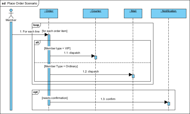

Sequence Fragment Example- Place Order Scenario
A member of a ship who would like to place an order online. The item ordered will be sent to the member either send by courier or by ordinary mail depending on the member status (VIP, Ordinary membership). Optionally, the shop will send the member a confirmation notice if the member opted for the notification option in the order.
Sequence Diagram Place Order example
