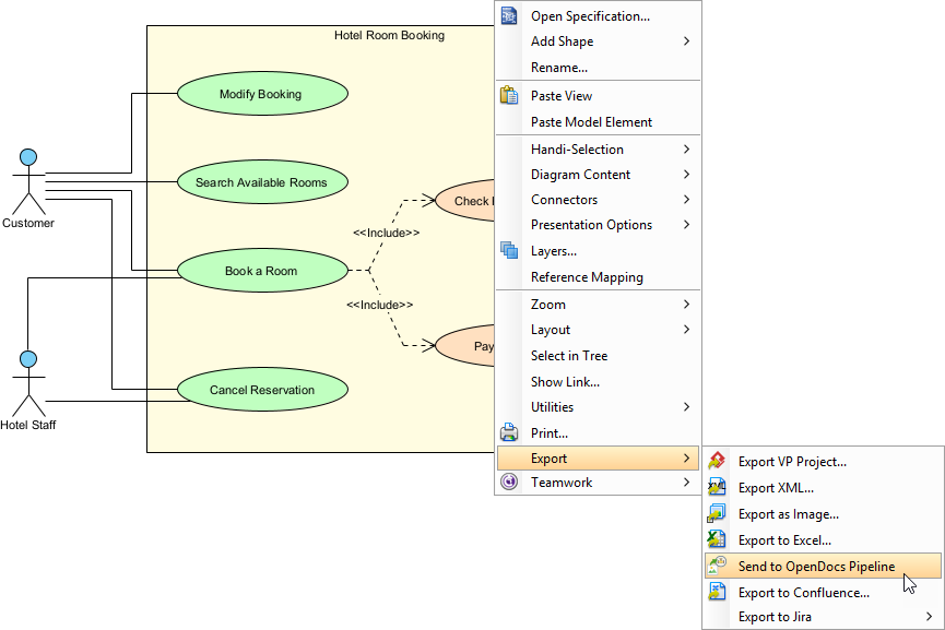

Step 2: Initiate the Export
I right-clicked on the diagram and selected Export > Send to OpenDocs Pipeline from the popup menu.

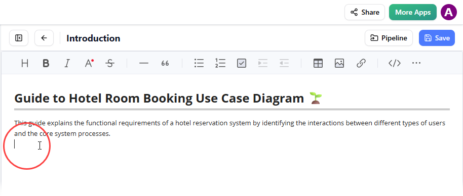

Step 2: Position Your Cursor
I clicked on the exact spot in the page where I wanted the diagram to appear.

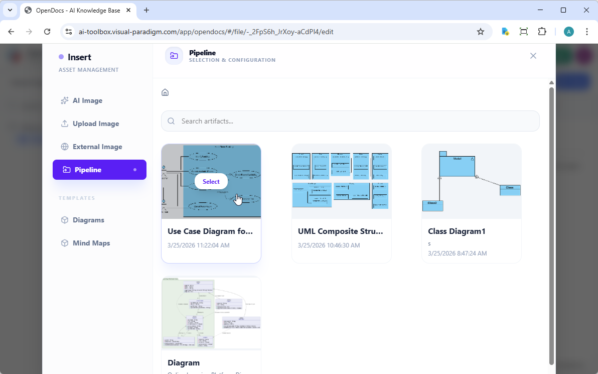

Step 4: Select from Pipeline
In the Insert window, I selected Pipeline from the left-hand sidebar. All my sent diagrams appeared here, ready to use.

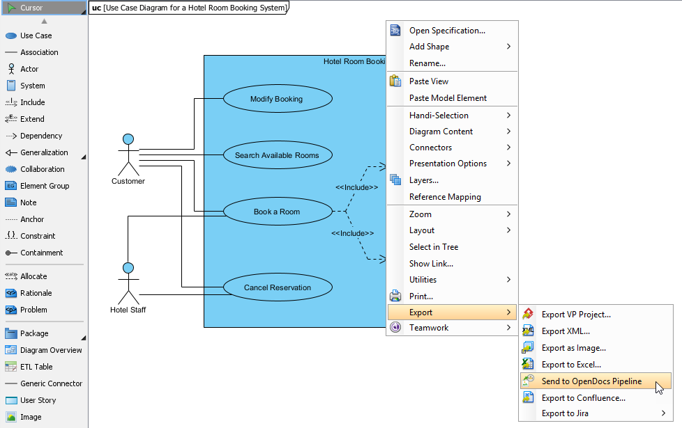

Step 2: Edit and Re-send
I made my modifications to the diagram in Visual Paradigm Desktop. Once finished, I right-clicked the diagram and selected Export > Send to OpenDocs Pipeline again. Alternatively, you can simply commit your changes to VP Online, which automatically creates a new revision of the artifact.

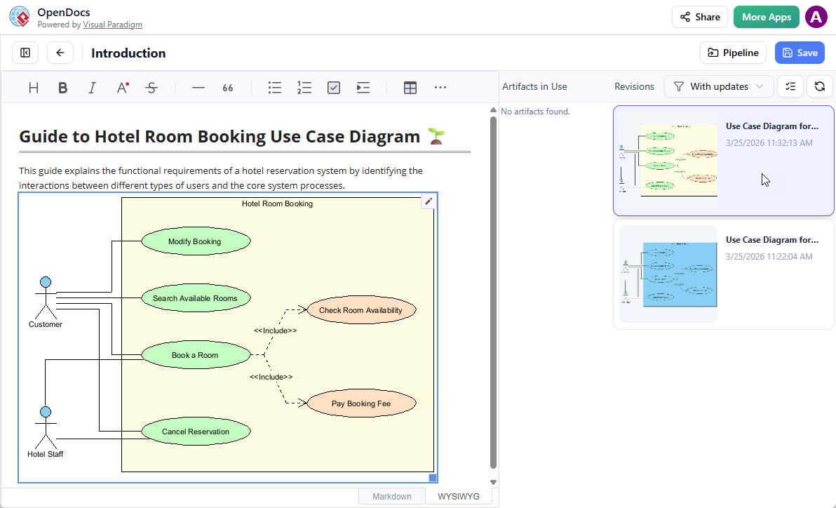

Step 3: Swap to the Latest Revision

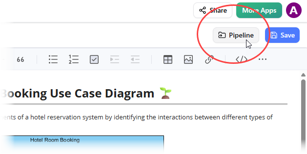

Back in the OpenDocs editor, I clicked Pipeline at the top right to access the artifact manager.
Open Pipeline Pane
I saw all the artifacts currently used on that page. When I selected my diagram, a list of revisions appeared. With a single click on the latest revision, the old diagram was instantly swapped for the updated version.
Replace with New Revision
