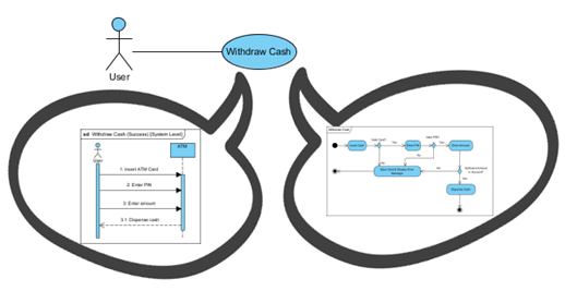

Elaborate a Use Case Using UML Activity Diagram and Sequence Diagram
A use case is used to model the goal which a user wants to achieve when using the system. However, a use case itself does not involve any detail about how to achieve this goal. Instead, it contains various scenarios, and each scenario becomes a possible execution path in the system.
In order to model the detailed interactions between users and the system or even between different models of the system in each execution path, we can use a UML Sequence Diagram. Furthermore, we can also use an Activity Diagram to model the overall flow logic of the use case.
15 elaborate use case

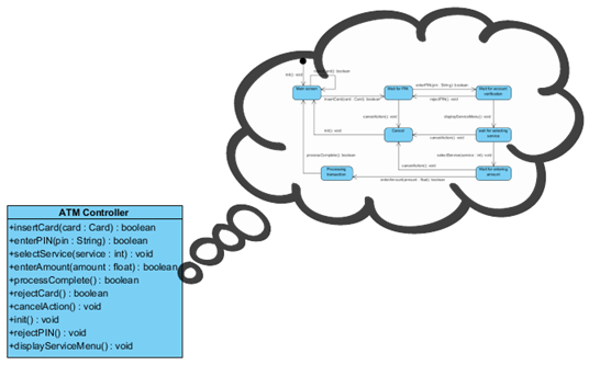

Elaborate the Internal Stage Change of a Class
While classes are the basic construct for building a a system, a class model focuses on the static structure of the system. We can make use of the State Machine Diagram to model the internal state change of a class against external events at runtime. This helps us to understand the dynamic behavior of a class.
16 elaborate class

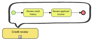

Elaborate BPMN Activity with a Sub-Process Diagram
The sub-process in a standard BPMN notation provides abstraction for internal details by creating sub-process diagram(s) for elaboration.
17 elaborate sub process
