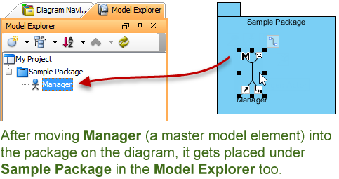

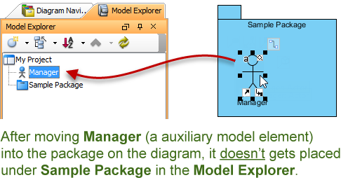

The master model element controls the placement. For example, if you drag a master model element (e.g., actor) into a package on a diagram, you will see it in the Model Explorer under the package. But if you drag an auxiliary into a package instead, the model element won't be placed under the package.
moving a master model element into a package
moving an auxiliary model element into a package
