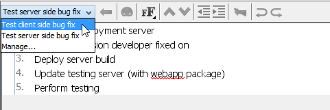

  1. Click on the combo box in the Procedure Editor and select Manage... to open the Procedures dialog.

For tasks with multiple procedures defined, you can click on the combo box in the Procedure Editor to switch between the working procedures.
