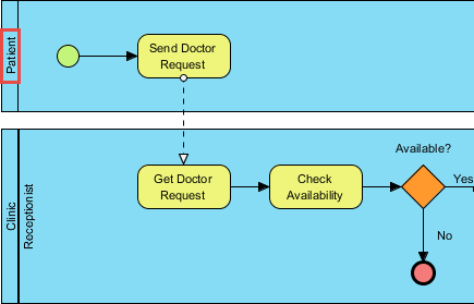

patient bpd
To solve this problem, you can centralize the common glossary term—in this case, Patient—into a common glossary project. After that, add this glossary project as a referenced project to the two projects that contain the word Patient. (The detailed steps will be shown in a later section.)
The benefit of centralizing the common glossary term is that it saves time because you can simply add the common glossary project to all projects that contain the common terms. Furthermore, since all projects are referenced to the same common glossary project, it guarantees that the definitions in all projects are completely standardized. If you want to amend the definition of a term, you can simply edit it in the common glossary project, and the corresponding term in all projects (that you have added this referenced project to) will automatically be updated. This also saves time and avoids missing any of them when you need to amend a word. Therefore, centralizing the common glossary term completely solves these problems.

  17. Repeat the same set of steps on the BPD in the project Sample BPMN Business Process Diagram.vpp. You should see the pool name Patient being highlighted. With the technique described in this tutorial, you can create a central repository of glossary terms and have other projects reference it to access the definition of terms.
    Term highlighted in BPD
