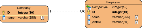

  4. Draw a Company entity. To draw an entity, select Entity from the diagram toolbar (on the left-hand side of the diagram) and click on the blank area of the ERD to create one.
    created company entity
  5. Right-click on the Company entity and select New Column from the popup menu.
    creating new column in entity
  6. Enter + ID : integer. The "+" stands for a primary key, while ID is the name of the column and integer is its type.
    adding primary key column to entity
  7. Press Enter and create another column: name : varchar(255). This column is not a primary key, so you don't need to add a "+" before it. It's a varchar with a length of 255.
    adding name column to entity
  8. Press Enter to confirm editing.
  9. Press Esc to complete column creation.
  10. Let's create one more entity. Move your mouse pointer over the Company entity. Click on the Resource Catalog icon at the top right and drag it out.
    create shape with resource catalog
  11. Release the mouse button in the empty space on the right-hand side. Select One-to-Many Relationship -> Entity from the Resource Catalog.
    create one to many entity
  12. Enter Employee as the entity name.
    created employee entity
  13. Right-click on the Employee entity and select New Column from the popup menu.
  14. Again, enter +ID : integer to create a primary key for this entity.
  15. Press Enter and create another column: name : varchar(255).
  16. Press Enter and create another column: jobtitle : varchar(50).
  17. Press Enter to confirm the edit.
  18. Press Esc to complete column creation.
    columns added to employee entity
