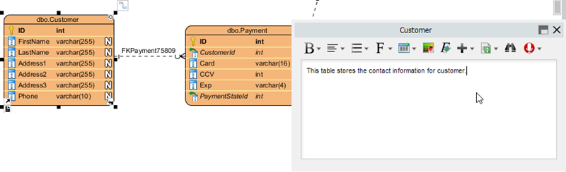

After creating the context-sensitive ERDs, you should have a good understanding of your database. You can now start documenting its details. To document the database, select the entities in the ERD and enter a description for each entity in the Description pane. You can show the Description pane by clicking the Show Description button on the right of the status bar.
Show Description pane
Then, select the entities one by one and enter their descriptions.
Describe entity
